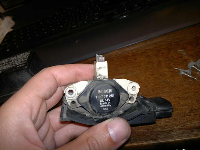

Tomorrow ill get it out to see if the diodes are burnt...And where is the voltage regulator, is it in the alternator or is controlled by the ECU?
I checked the alternator
This is the voltage regulator together with the brushes.
Also the 65A battery fuse was blown.
The brushes look fine to me. Anyone know how to check it with multimeter?
