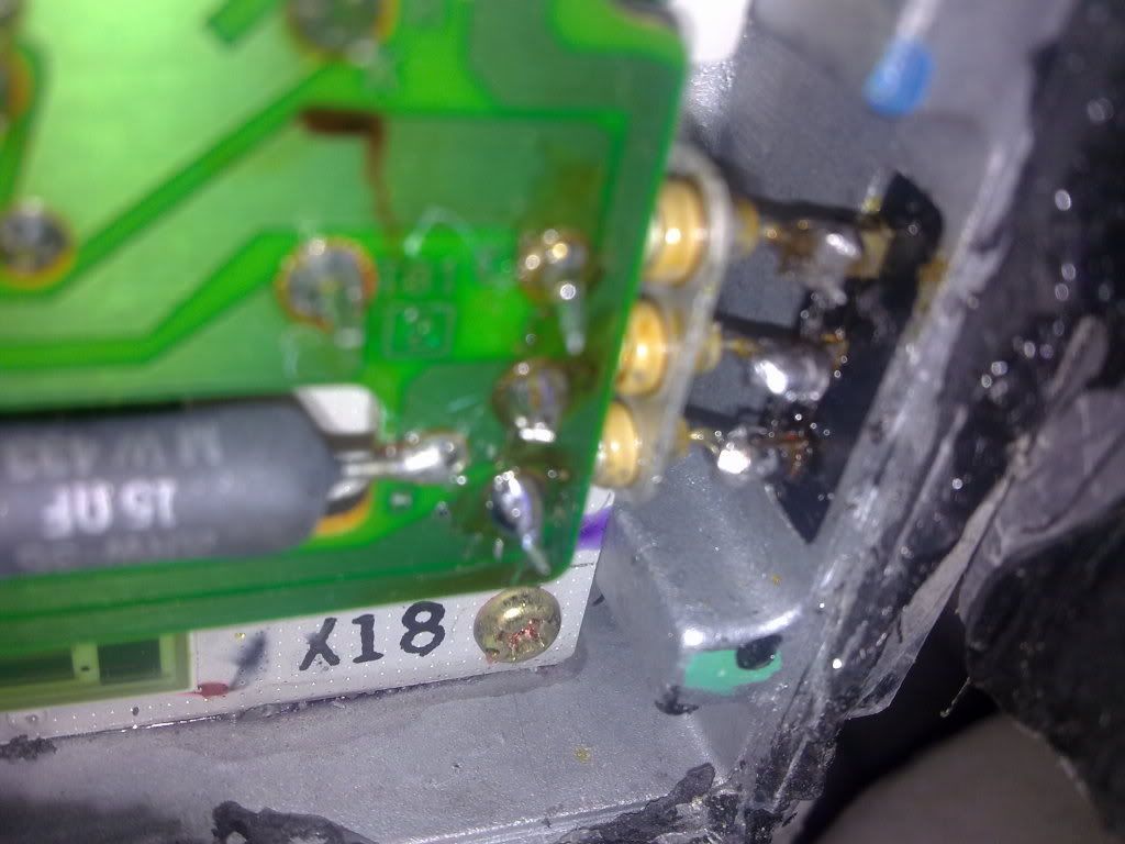

my xitty soldering, I know on all 6 pins had to be redone as Stuttering started to take place widlly during driving and especially when cold starting....
<a href="http://s267.photobucket.com/albums/ii296/funky2nite/?action=view&current=161020111501-1.jpg" target="_blank"><img src="http://i267.photobucket.com/albums/ii296/funky2nite/161020111501-1.jpg" border="0" alt="Photobucket"></a>

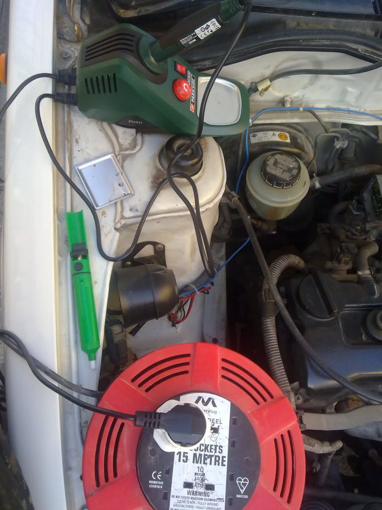

Tool kit required for anyone doing it for the first time, I use a multi tool swiss knife and use the knife blade to open up the side access to the pins at the LEFT hand side of the T/B.
<a href="http://s267.photobucket.com/albums/ii296/funky2nite/?action=view&current=121020111483.jpg" target="_blank"><img src="http://i267.photobucket.com/albums/ii296/funky2nite/121020111483.jpg" border="0" alt="Photobucket"></a>
