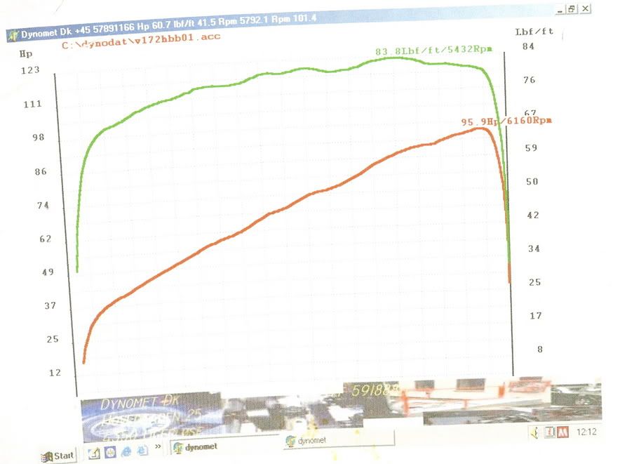

CMF_Raceworx
» CMF Member
Member since:
Posts:
mine was dyno'd at 95.9 BHP with just a janspeed manifold de-cat and straight no box exhaust system oh and a crappy cone airfilter with no cld air feed..
thats a 1.3 youll be hard pushed on a 1.0 to get up to 100BHP n/a without spending alot..
