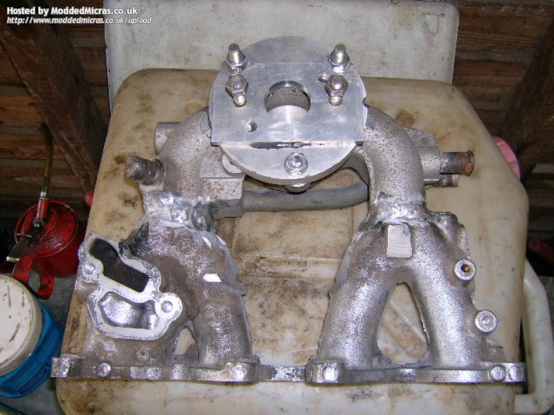

the only carb thats work on a standard micra inlet manifold is the single choke34 ich weber and thats been proved on the rolling road against a 26/32 dmtl weber ,youve got to remember that the standard inlet only has a 26mm track through it and also if the 34 ich was good enough to fuel 2.5ltr land rovers its plenty for a micra.
I still have this inlet manifold for sale that takes the 34 ich weber if any ones interested £80 inc p&p

34 ich webers have all the same fitting
have a word with this man on ebay he nose his weber.
http://search.ebay.co.uk/_W0QQsassZfastroadcarQQhtZ-1
