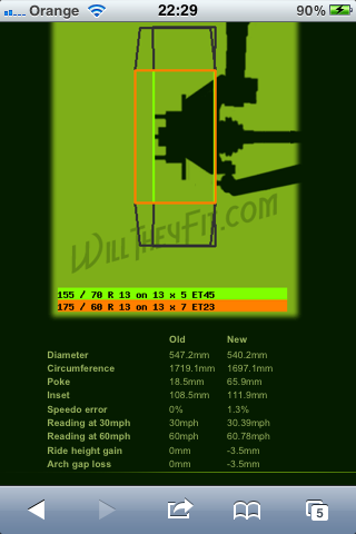

Yeah i have been playing around with that too but its hard to see what it would look like actually on the car. Whats the rim width and offset of my standard steel wheels (155/70/R13)?
Do you think these will poke out from the arches??

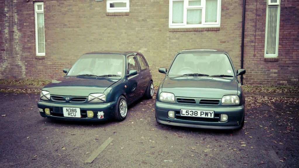

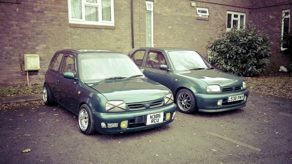

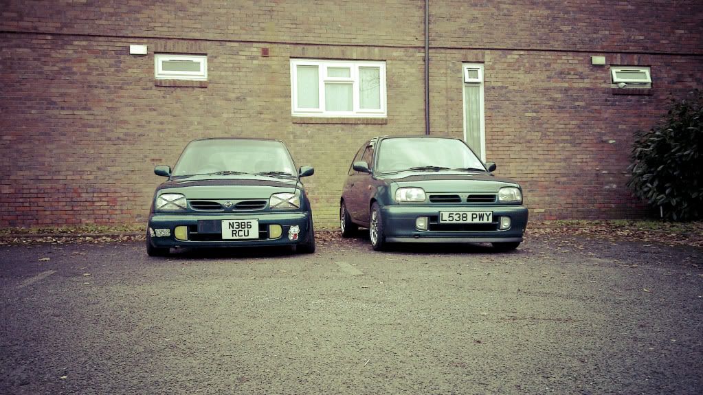

this is my old setup against yours.
wheelimage.php
my needed some little archwork and some front negative camber, so i think your will be lucky. It also depends how low you go
my old car on the left with the wheels setup mentioned
