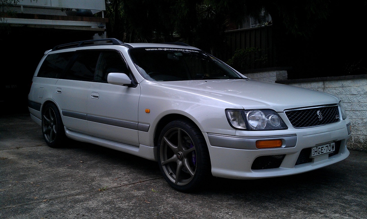

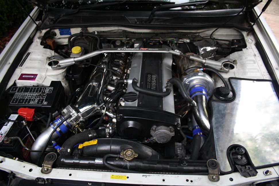

lol I know the problem....too many projects! I've just got my stagea (skyline station wagon) back with a fresh 3.0l motor and high mount turbo. 300+kw at the wheels so about 400hp at the wheels or 500+hp at the engine. It's 1700kg but it still flys.

You using an rb25 head and a rb30 block? If you were going to do that why didn't you use a rb26 head? I'd of imagined you'd get a lot more than 400whp with that type of work, my rb25det was running 400bhp with very minor work
Also that stagea is nice, would look nice with a r34 front end swap! As I see you already heave the rims
ahh well the rb26 head might give more power, but I already had the rb25 head on the motor that was coming out (and all the loom/ECU etc) so I just re-used it. It is just a tow car afterall ;)
And yes there are a few r34 front stageas getting around here, and I reckon they look great......but same answer, it was always meant to just be a tow car!
