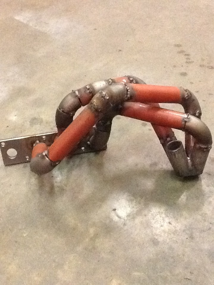

I've had a go at this today
Been having a quick mock up off things
Please don't take the piss out the tack welds to much, the welder was playing up big time!!!!!
Ran out of regulator broke, then ran out of gas, kept jamming the wire too!!
Bloody cheap crap!
Anyways......
Ran out off fittings now
Thats bloody awesome mate! Hats off to you!
Right... where do i get this steam piping? Im gonna make me a ram horn one! haha

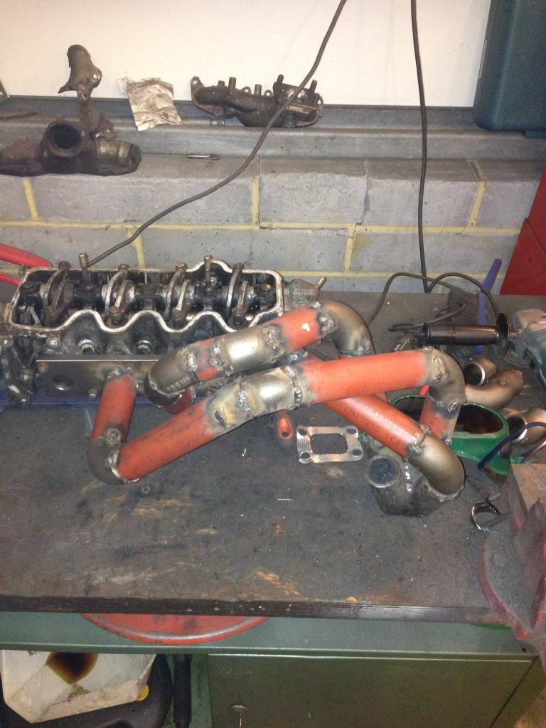

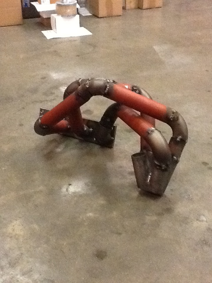

Exhaust mk2
All runners are equal length now with as few bends as possible
Your thoughts please people, because if there isn't anything I'm missing, I'm gunna weld it all properly tomorrow
its good, it seems to have quite equal lengths eh?
Yeah, tried my best, there roughly 14inches each
Tried to get as straight as possible too, would like to of gone straight into collector though, but also these loops help avoid the radiator hoses going into engine
I couldn't think off any other way off doing it
I read the same thing, from engine basics site, apparently helps with that, and helps with being able to have higher compression (from what I've read!)
