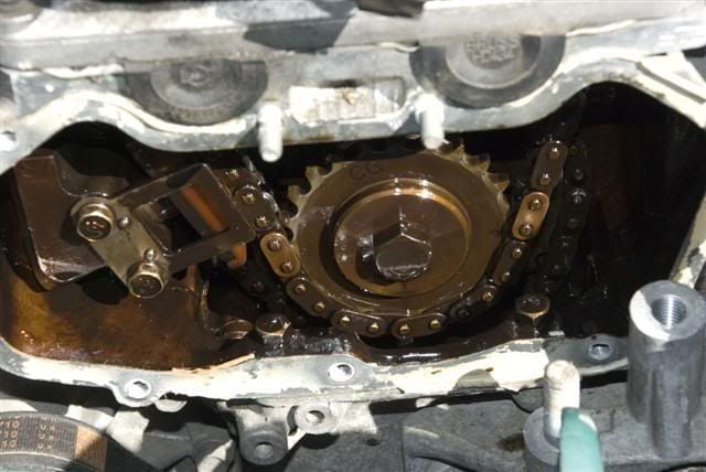

If you see gunge on a low mileage motor its probably just been a long time between oil changes.
Regular oil (& filter) changes are far more important than using the most expensive best quality oil.
Use the right viscosity oil for the ambient temperature, e.g. for use above -10C use 20W-40 or 20W-50.
I can't quite recall the source of lubrication oil for the chains but there is an oil supply for the bush in the centre sprocket and the tensioners are hydraulic, so it's probably lubricated by the seepage from those.
On a sludged up CG13DE I had apart the oil supply to that centre bush was quite clogged.
If you've got noise from the chain you'd be best stripping it all & cleaning. I'd guess you'll find worn tensioners and/or guides at the same time that could do with replacement

The top tensioner was the only badly worn component on the slugded up motor I pulled apart that had a bad timing chain rattle (shake a paint tin with a few bolts inside & you'd get an idea of the noise at idle). The plastic block was totally worn through (a good 10mm of wear) & the chain was in the process of wearing through the pressed metal saddle that holds the plastic block against the chain. Both guides & the lower tensioner only had ~1mm deep grooves worn in the plastic. The the oil supply to that centre bush was quite clogged but luckly it hadn't worn.
The top tensioner can be changed relatively easily, i.e. take the side plate off & unbolt the tensioner.
It doesn't require taking off all belts, the sump, lower cast chain cover, chains, guides and anything else that got in the way.
A complete set of chains, guides & tensioners is fairly expensive. If you're dong the job yourself & don't value your time too highly, I'd definitely do some inspection first.

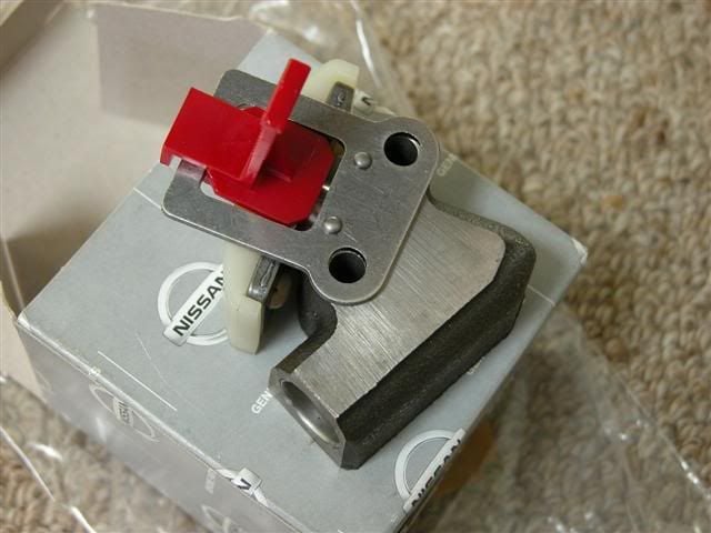

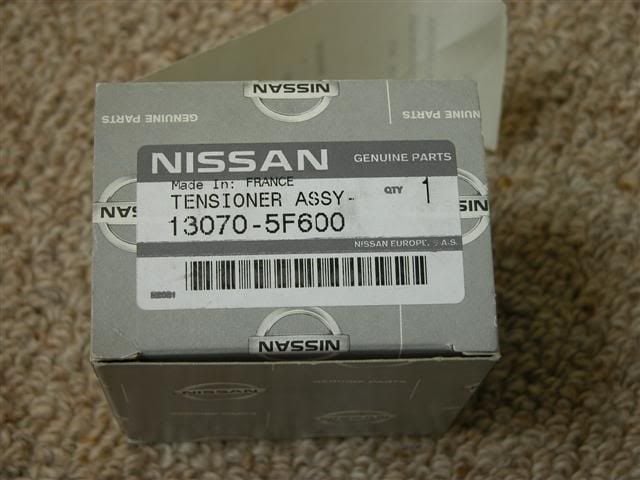

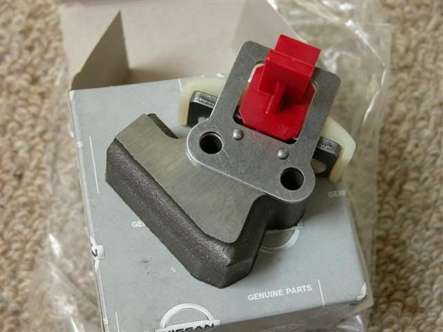

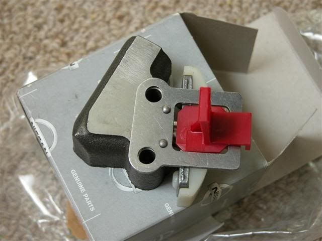

Well 'er indoors just got in with the new tensioner assembly. It's spring tensioned rather than hydraulic - maybe that's the "update"?
The pack also has a red plastic thing in it which I at first assumed was some sort of setting device. Anyone know what it's for please?
I don't know if I can post multiple pics - if not please forgive me foe makeng several posts to let you see them

I would have sworn the top tensioner was hydraulic as well as having a spring. The back of the tensioner shown above has an oil passage in the back. Is what I have circled a drilling or something else?
I've still got a bag of bits somewhere, might try finding them tonight & getting some photos.
That red plastic thing looks like it's supposed to hold the tensioner retracted to make assembly easier. I would have held it retracted with my fingers or pliers.

Aha - I see the pressurising hole now AJ, thanks.
There is another one that I have referred to as a breather - which probably lets the excess pressure escape whilst doubling up as a spray directly to the rear of the chain.
I too think the red plastic component holds the unit retracted - but the piston won't go fully into the cylinder no matter how hard I try to compress it against the spring tension. Those nibs in the small component that the spring sits in stop it from retracting. They could be a means of limiting how far it will retract when the oil pressure ceases when the engine is stopped.
I feel inclined to smooth them off a tad so the spring can be compressed - but I guess I ought to speak to nissan mechanic first - or at least see what the old one is like. I'd prefer to know how to compress it before I commence the work though.

Sorted now thanks guys. Someone on another forum put me right about the last cut out where the nibs are - I played about with it and it held in nicely.
The plastic retainer holds it in while you mount it - and releases the tension when you retract it. These online forums are absolutely brilliant - sooner or later you will always find some one who has or had the same problem.

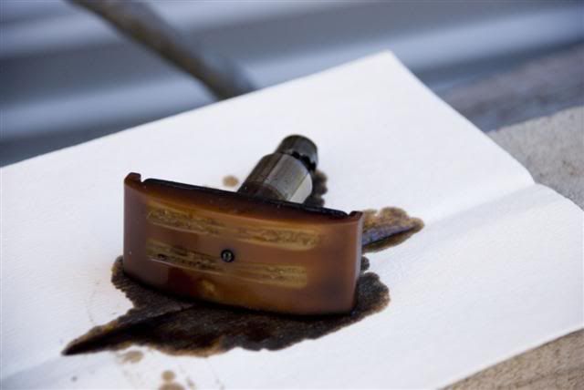

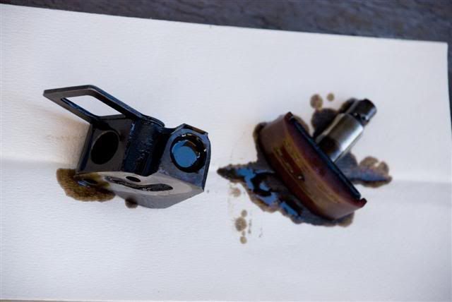

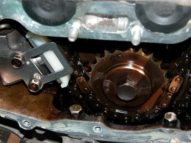

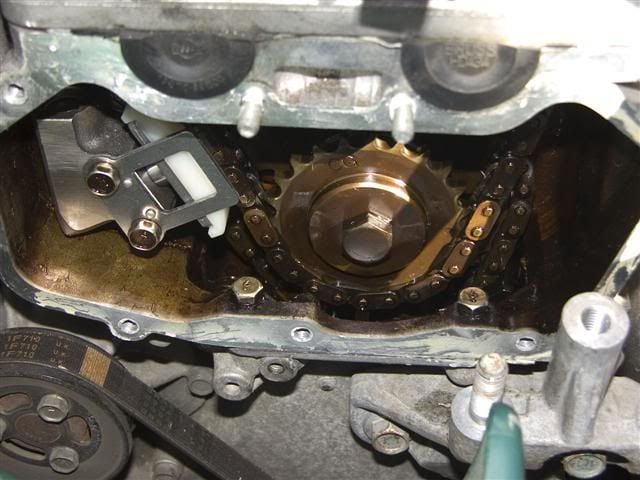

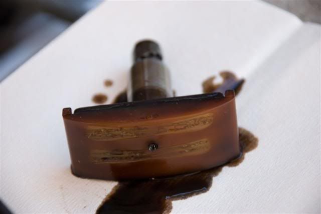

Well I changed the tensioner over yesterday. Hasn't fixed it. Pretty annoyed about that actually. Sounds very slightly quieter on cold start, but I don't know if that's just me wanting me to hear it as quieter or not.
Some pics of the process and the wear on the original tensioner. I expected it to be a lot worse than it was. Odometer currently is 127,300KM.
The old tensioner before removal
The wear on the old tensioner
Another shot
Wear marks again
Pics of the new tensioner installed
There you have it.
---dens
