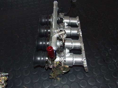

Would throttle bodies on a 1.0l make any difference. Came accross a guy making throttle body conversions & custom inlet manifolds.This is what he said and also sent a pic of a micra throttle body too........
''Once I have a manifold gasket I can cnc machine a manifold face to suit your engine.
Throttle bodies available currently are taper type in two sizes
1) 44mm tapering to 38mm
2) 50mm tapering to 42mm
They come with 4 injectors + throttle position sensor. Throttle bodies are ITB type so can be spaced to give a straight run into each port.
I can also manufacture one off manifolds for webers etc
Does this seem anygood ?
Without correct management, they are useless, you'll need to factor into the cost of this as well.
What cc/min are the injectors?
Craig
I have'nt got a clue what cc the injectors are, he didnt say. I take it a remapable ecu is a must also when you said management
