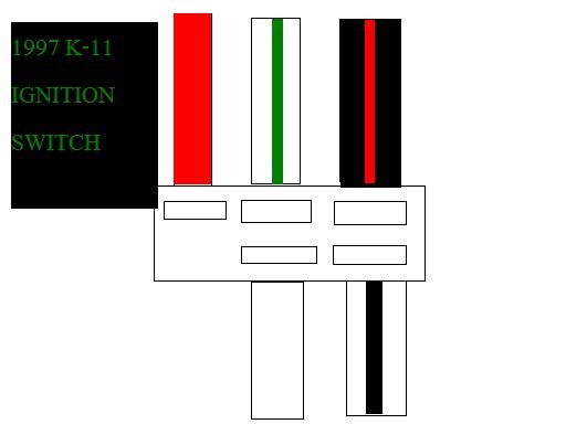

I GOT N REG 96 MICRA. some idoits try to steal it it nats 2 type transpoder in key. can i repair it with parts from scrap yard think the reader been damage and i unsure order wires go back on to barrel, the 5 progs dose anyone know which wire go where. 2 pins at bottom then 2 above the one at top. i be greatful of any help
try salvage transponder thing - fix switch first then check
THank you very helpful. it the bit that on side of barrel i on about that read chip in key was rip off found in car have refitted it if it damage can i use one from a other micra or dose it after match key
Just need to push wires back on thanks then see if it work. If car gone in to lock mode dose it need to reprogame.

it seems a prog job looking at your other thread------ anyway see after fixing what y
ou got
if the nats receiver was only rip'd off and not criunch'd up connect back up wires
and old switch will be beech
