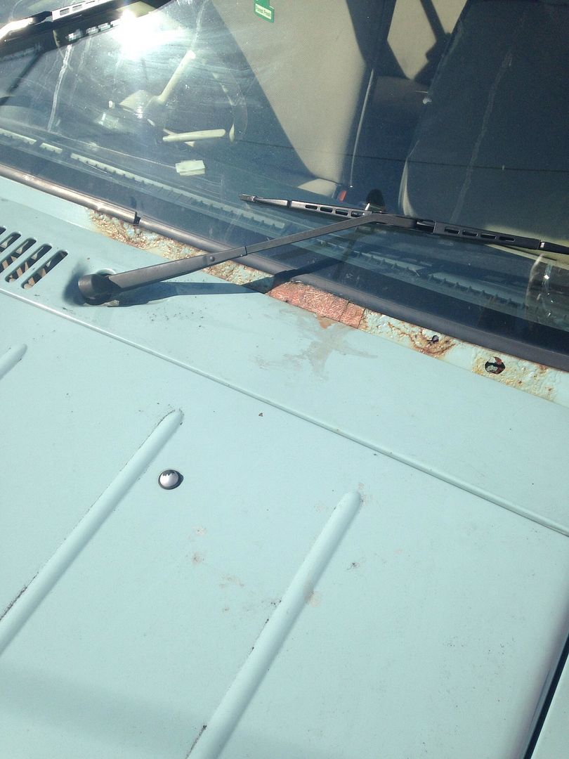

I picked up my Pao last week and seem to have the same rust issues around the windscreen
I will be interested to see how you tackle it as I'm quite new to welding.
Will be watching this with interest :)

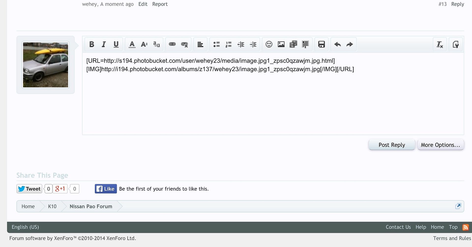

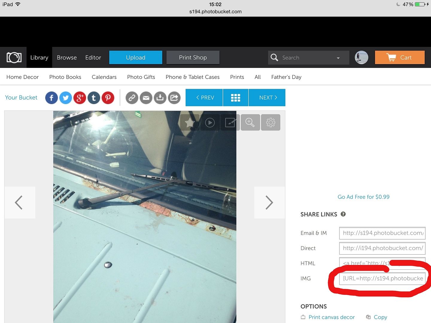

sorry to hijack your thread Russ but how are you 2 getting those pictures to show like that ? when i put pics in my thread they show as a tiny thumbnail you have to click on ? i tried an instagram link and a photobucket url but its not having any of it ??
You need to sign up to Photobucket, upload your photos, then copy the highlighted (in red) code into your post.
Like this
LOL I think the green colour is moss growing on it as the cars actual colour looks to be Slate Grey (blue) gotta love the little things to go through so much work, mine has a tiny bit of rust under the screen but not too bad yet, I have rust converted it for now to stop it getting worse, I am currently collecting parts for a Superturbo MA09ERT conversion
