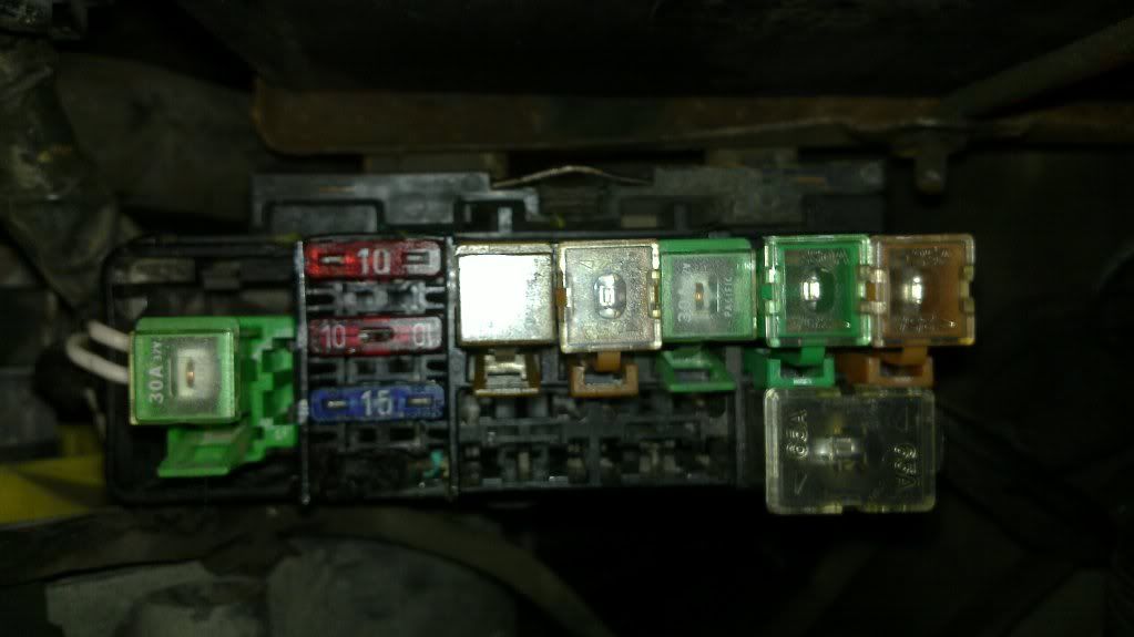

Did you check injectors fuse? Its in engine the bay. It can get really corroded. When my was bad the pump was clicking forever and light was on.
hey mckenzie i think you have it - clicking and light on.....thass the prob for me!!
can you tell me which fuse is for the injectors? 3 of the fuses in the box in front of the battery are not identified on the top of the box, is it one of those?
the 3 unIded are 10A and 2 at 15A.
also if the prob really is corrosion, how to fix?

You should have it same, my LH lamb fuse is missing atm so hope its not confusing.
I just cleaned the fuse with bit of sandpaper and sprayed WD40 into the holder.

i looked at all of the smaller fuses - all of them are in perfect nick, so ,,,um,,,,,,,

did you change the injector fuse? you do have fuel injecting 100%. I have known fuses to blow slightly (crack) but look fine, worth a try.
did you check the fuse box to the left of your engine bay for the headlight fuse?
