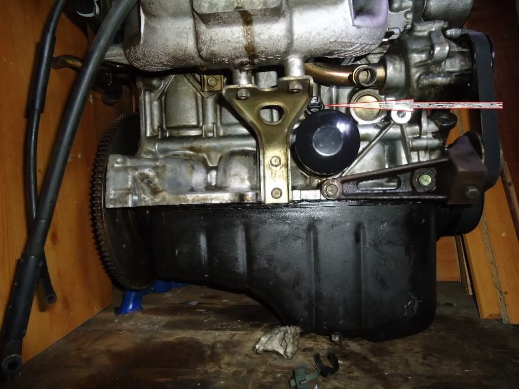

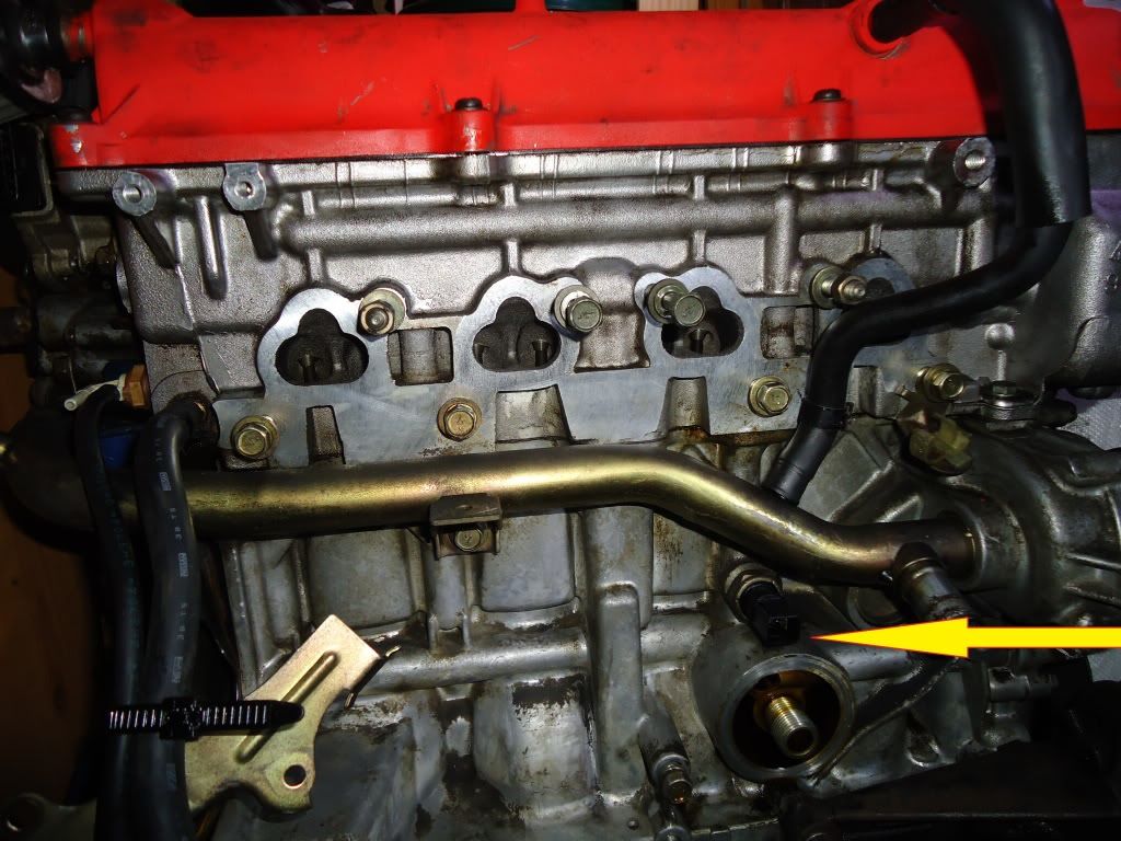

does it look like a sensor if so it goes down under the inlet manifold and above the oil filter.... its a B***H to get to to even unplug it
here are a couple of pics one with in inlet manifold and one with to show how awkward it will be and this is the back of the engine might be anble to get to it with removing oil filter and from under neath! change the oil and filter at the same time?
follow the arrows
hope this helps mate if not im sure someone can :p
Hi Mate, Cheers for the pics might be one for my mate "the mechanic"!!! the sensor I have has one spade type connector on it...............
yes will has shown you the oil pressure sender eh :eek: the coolant temp sensors are under the dizzy duroo (the 1 wire one for the gauge, and the 2 wire one for the ecu)
