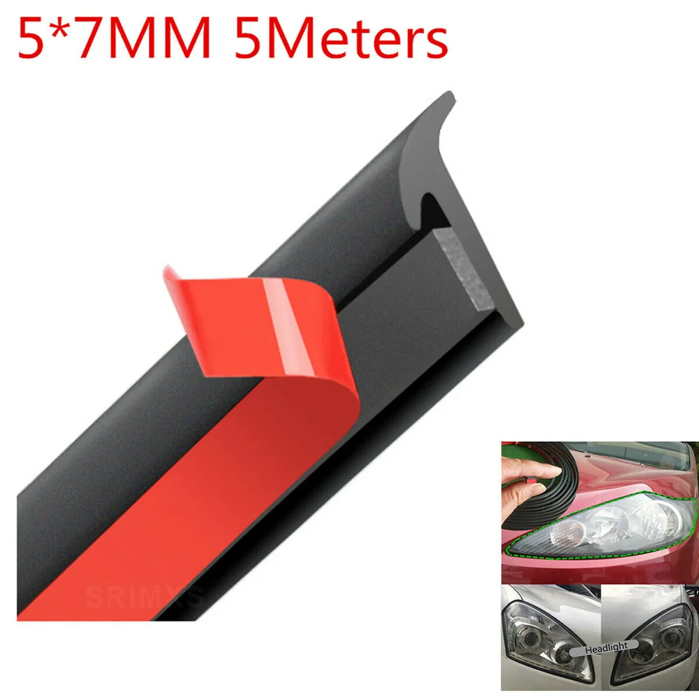

I have bought some T-type 7 x 5mm rubber strip, I will let you know how it works when i get it. It will leave a 5mm black rubber strip showing around the top of the handle, but if it stops water getting into the boot it'll do.

I have applied the T shaped rubber seal and it is all good as new. It was a bit tricky to get the rubber to go over the edge pf the handle esp around corners, but used a thin piece of flat plastix to pop if over the edge.
