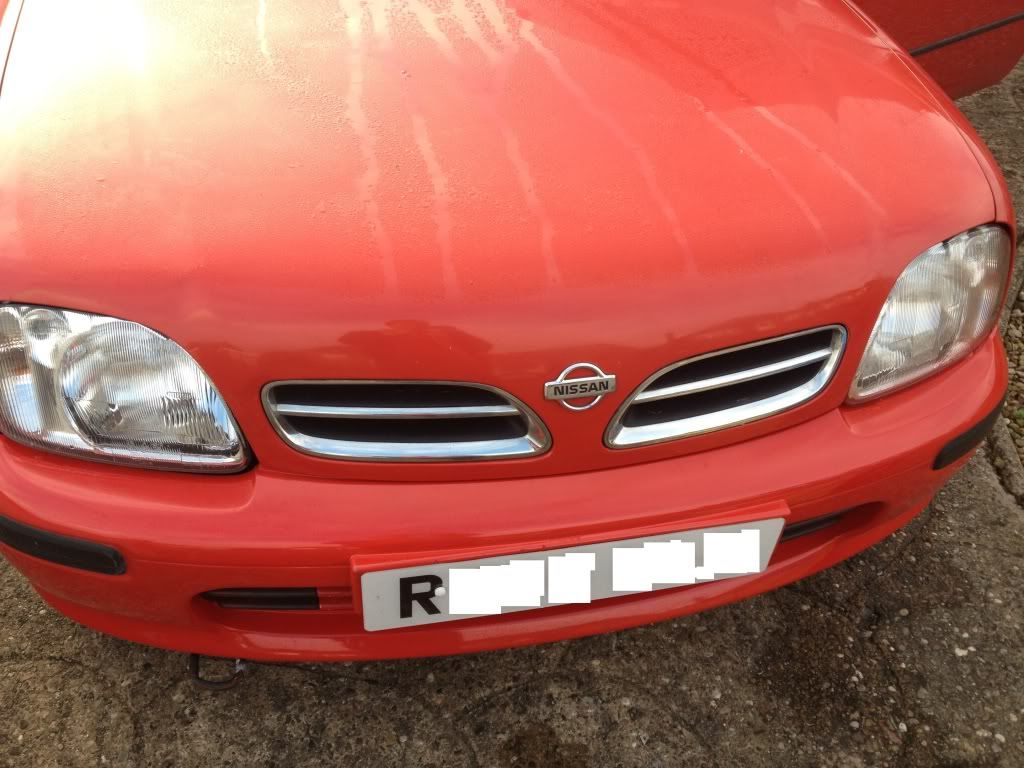

I've search on this forum and read some of the threads but im still a little confused. Most people here refer to "facelift" and "pre-facelift" models and im not sure which constitutes as which. Below is a photo of the front of the car its an R reg and according to the DVLA manafacture date is 29/06/1998.
