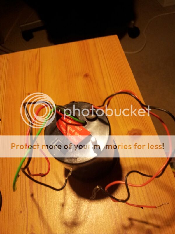

Hi all, got myself a used tacho but have no idea what the wires from the tacho should connect to? For instance i dont know which wire is the ground wire....
The little sticker on the back reads 'for 12V negative ground'

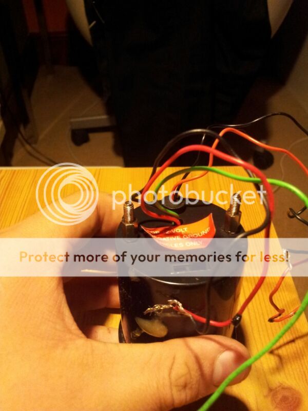

Also no idea what the two metal studs on either side are for? Shown below
Any help?
The studs are just for mounting bud

You'll need I think green to coil negative wire, which is light green/black on the car from the coil plug
Black near ur green wire will be earth
Red near green wire 12v switched live
Wires in the other grommet on the dial black negative red 12v switched live for the dial illumination
Id imagine that one of the red is for live and other is for light( like when you turn dash lights on) and the Green is signal. Black is of course negative
