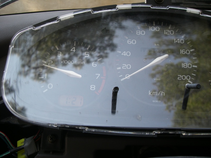

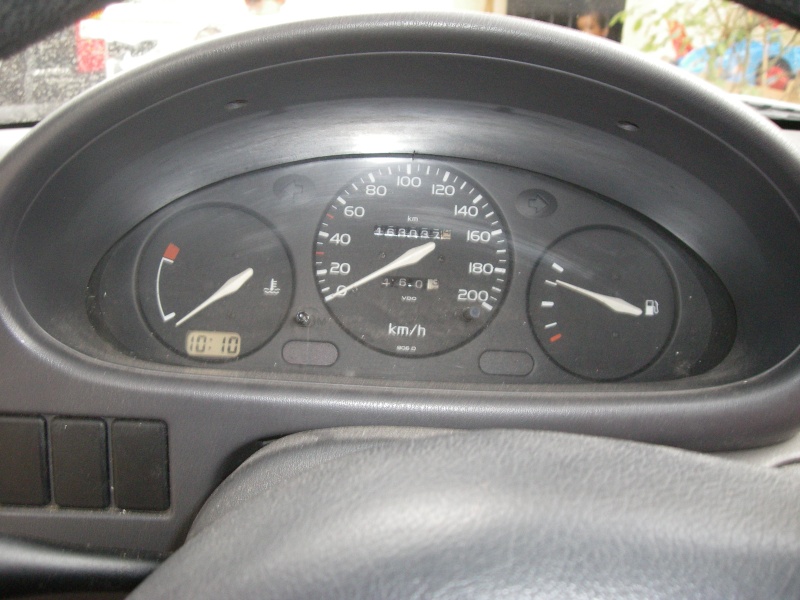

Hello,
I want change my dashboard
to this with the tachometer
but i have a problem:
the tachometer don't move :(
perhap's one connection is missing :confused:
but the connection are the same on the 2 dashboard
can you help me :oops::rolleyes:

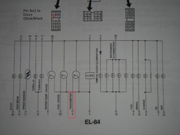

hello, it's me again :p
somehone can explain to me this wiring diagrams :oops:
if in the diagrams the pin 2 go to the dizzy
it will be good ??
in this diagram the pin 7 is for the oil jauge but in my car this the pin 2 :confused:
and if the diagram explain the back of the dash bord ,in this case the pin 7 is for the oil jauge :oops:
sorry again for my very bad english but it's a very hard job to me to try find answers in an other language :confused:
ok, if i understand , i put a wire on the big connector in the pin 2 and this other side on the gauge cluster o_O
but where on the gauge cluster ??
In that pic i posted on the last post, you have to fit a short link wire from the big connector to the smaller connector :)

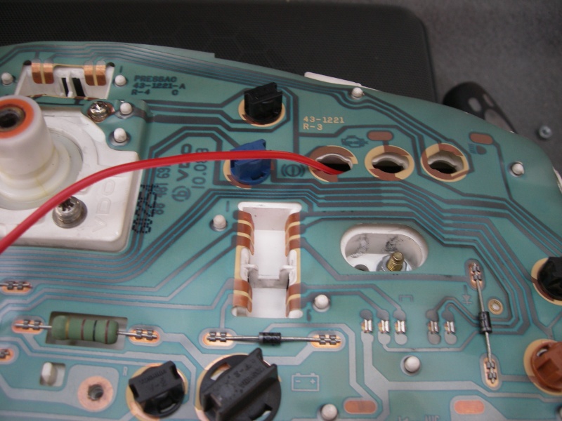

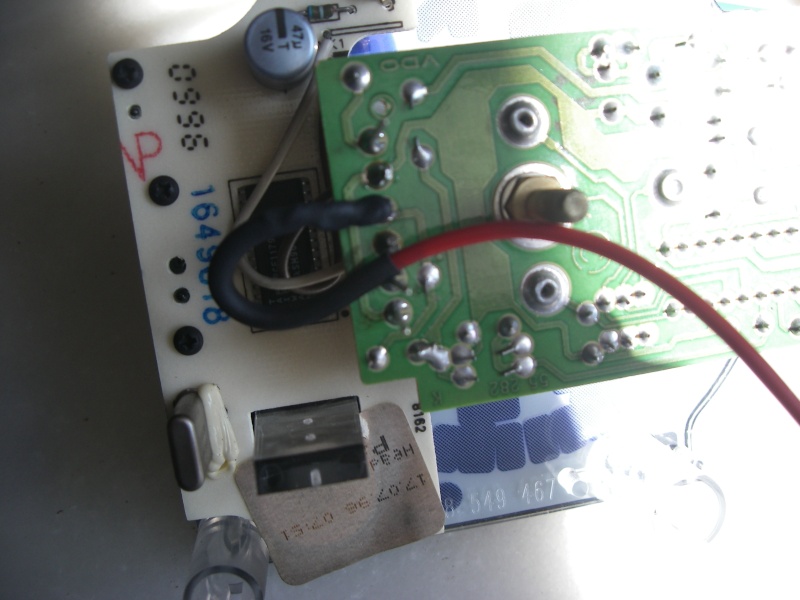

Well,i'm back :D

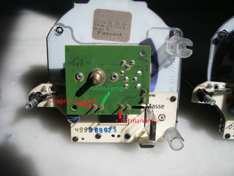

the answers of my problem is the wirring of the tachometer comparate to the temp indicator
An pics is too easy to explain this

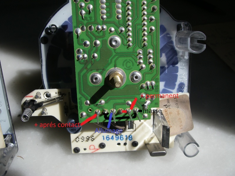

the temp indicator
and the tachometer
the pin where the dizzy wire do to go came on a blind pin in this case, the tachometer can't take the dizzy info and don't work!!!!

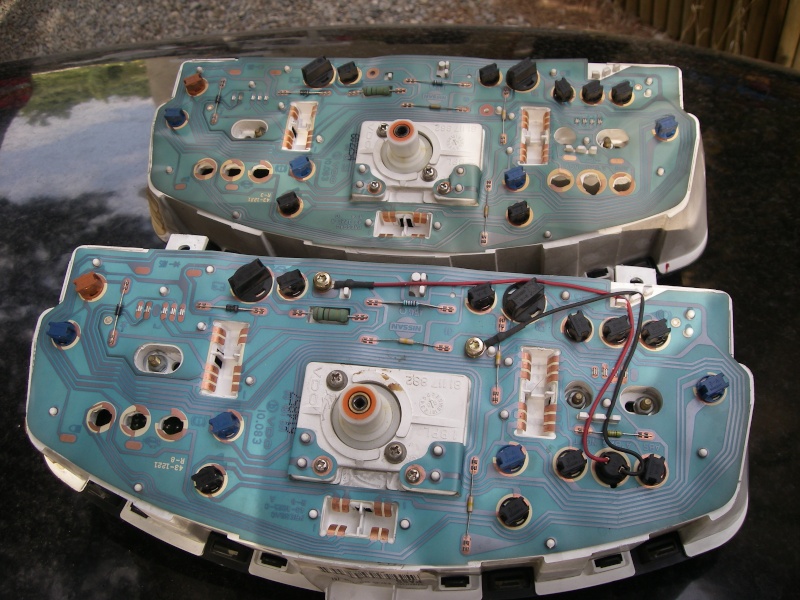

So i made this ,
you can rebuild the cluster jauge to put the wire to dizzy on
and now turn the key to run the engine and enjoy ;)
