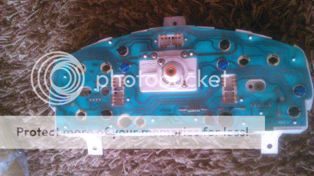

Thanks for the Info DavboyI'm pretty sure that one is wrong for you George.
That's a cable drive, you need a plug in and play now you've changed your motor.
Have a look at the back to see which one you need.
I've put a couple of pictures up to show which is which.
Dear DavboyI'm pretty sure that one is wrong for you George.
The last one is plug in and play George.
If that matches the back of yours...your away buddy.

Prerfect!!!You can use either of the 2 middle ones in the links you provided. The first and last are electronic speedo drive and won't work.
Dear agentYou can use either of the 2 middle ones in the links you provided. The first and last are electronic speedo drive and won't work.
You are right Frank i notice that my plugs with micra ones had different plugs.march dash,s have different plugs to micra ones george btw
totally different wiring loom on the march george, there was some info on cisco,s micra filesYou are right Frank i notice that my plugs with micra ones had different plugs.
So i guess i need march dash with rev in order to connect it to my March.
Little difficult to find..
I found only micra dash with rev
So a had to put aftermarket rev counter.. i don't like it !
Really ? Ohh no.totally different wiring loom on the march george, there was some info on cisco,s micra files
