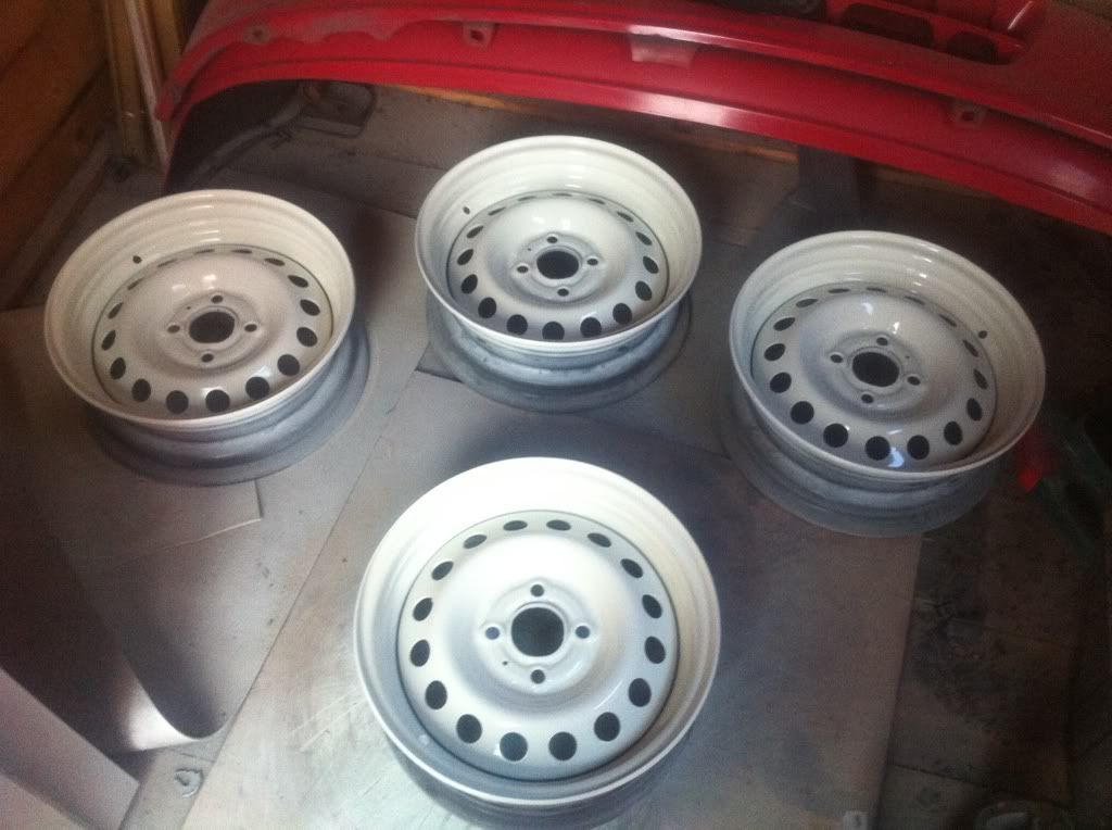

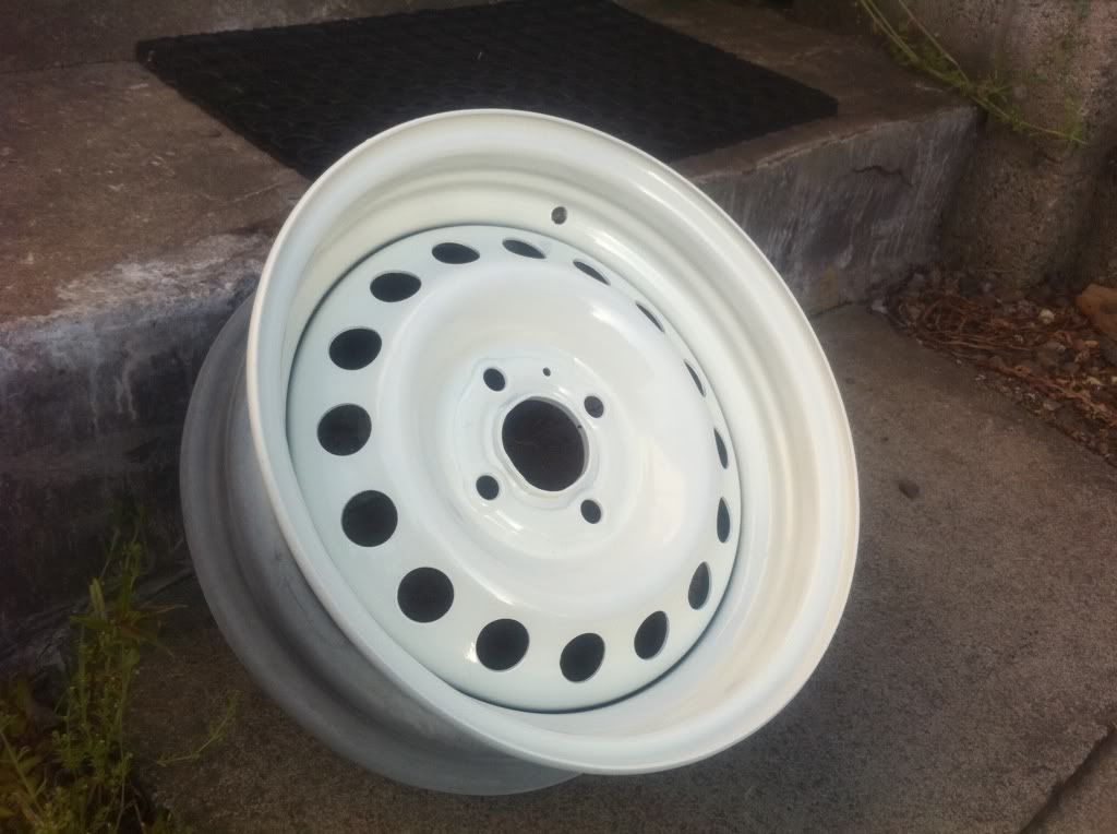

Hey guys i finally picked up my first micra yesterday insured today :) my first car ever, shes a good wee runner silver 1lt micra s 2001, straight into the mods, I want to paint my steel wheels purple, anyone have any step by step guides to how i would achieve this? as i do not have a clue... any help would be excellent :)
Sand the wheels by hand, clean all the dust out. Prime wheels (couple coats) spray them desired colour (couple coats) then lacquer (i put on about 5 coats)
Youll achieve this
thank you, am i best priming it then painting it white then painting it purple? then laqur? and you have had no cracks etc?
alright so the purple straight over the prime? can you tell me what the best brand of rattle can would be to paint it purple?
i know i know... its just im not sure whether to go to halfrauds and get a purple car paint or go to the local graffiti store and buy the likes of belton? which would stick better?
