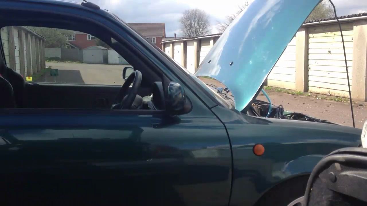

Right had her out of the garage and still no joy
I wound the idle screw out almost all the way which helped a little.
Could it be that I don't have the carbon canister attached or my battery could be completely knackered
I'm going to re attach the c/c and try again.
