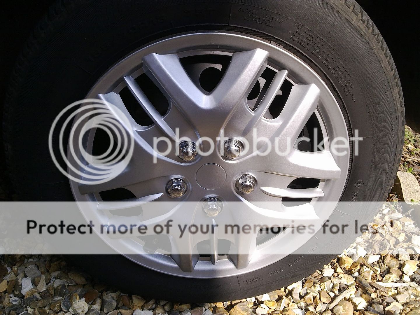

so far ive sprayed the metal bit of the tyre (not a clue what u call it) black and fitted my new hub caps :)

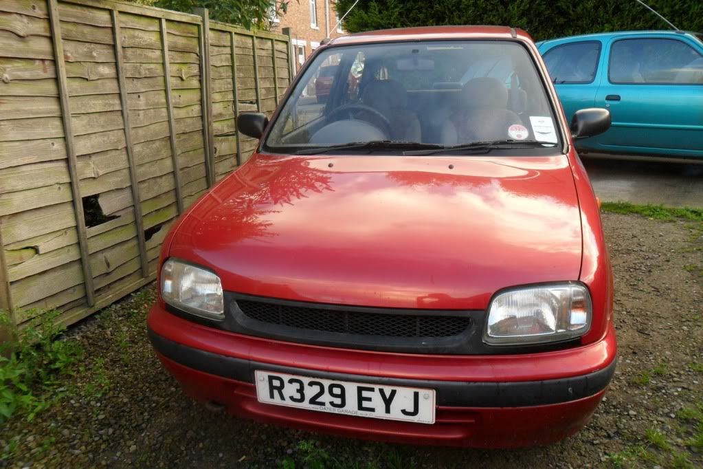

also im gonna respray my grill section so that the black bits are actually back but mine seem different i dont no if they are but its one whole section and i want to change it coz i dont like the big blastic bars and was thinking of mesh but how do i go about it? ill add a piccy of the grill section aswell asoon as i can :)

new hub caps on my sprayed tyres (obv not the rubber)
and how do i go about modyfying this type of grill?
it shouldnt be too difficult to modify the grill so its 1 hole, as long as you're pretty adept with a dremel and a set of files! as for the mesh: if you look on the back of the grill, you'll see theres like a lip that sticks out (towards the car) where the nostrils are. you need to leave this in place, despite cutting the rest out. when youve finished making the cut, drill small holes in the lip you left on, and bang a bunch of cable ties through. how i did it on my old car. would suggest though maybe do it with the front bumper as well, could look out of place otherwise. check some of the guys threads on here theres loads of great pics of micras! :)
hmmmm if i take the middle bars out of the black bits using my dremel and then secure some mesh behind it and try and sooth where the od bars where maybe with some filler and black spray would that look all right and ye im thinking of doing the same to my bumper gona be spraying my bumper completly matt black coz its abit grey XD:doh:

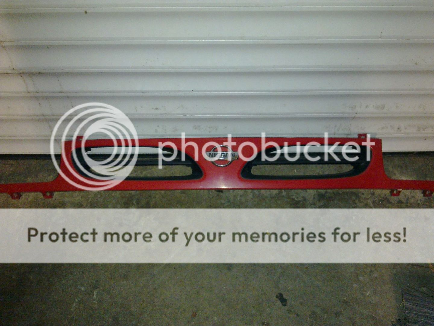

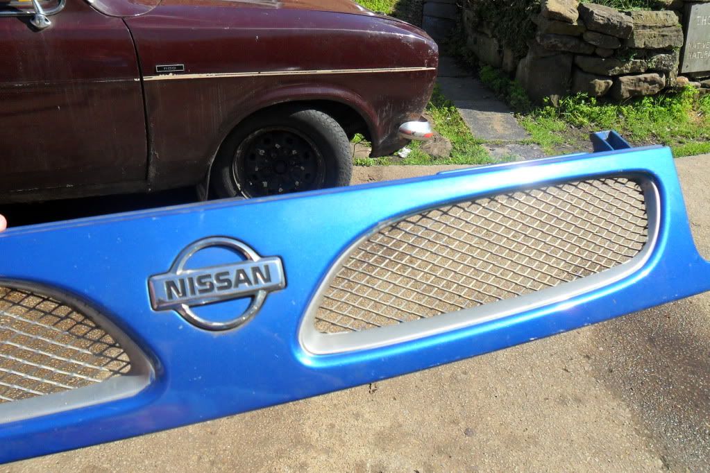

You mean like this north? :p
This is the other grill my dad has to choose between, and it does look nice with the chrome mesh and silver outline too, so theres a rough idea of what yours would look like (Y).. Also, i dont know what colours youve used around the rest of your car, but red and black would be my choice for it, having a red grill with black outline and black mesh would be nice imo ;).. But if youve not used that throughout the rest of your car then gan with whatever you like,, afterall its your own car not mine bud! :D. This mesh is also held on with tubes and tubes of tigerseal/silicone lol..
Also in the backgrounds a mk1 escort (Y).. sat next to a mk2 escort as well.. these are the reasons ive not done anything on my own car! Theyve taken priority over it lol :glare:
PERFECT they look well sweet well my theme is actually red and black under the bonnett is red black and chrome tho so you reackon the black mesh would be better? ill buy chrome mesh see the look if i like it it will stick if i dont itll get sprayed black :p

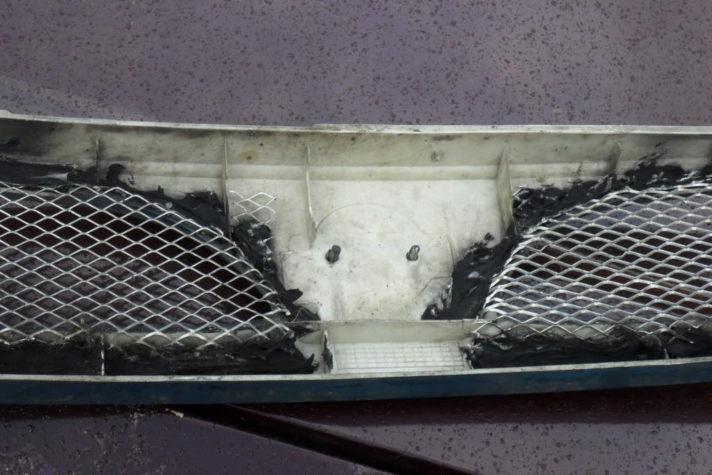

Ill take a pic tomorrow when i get chance, to show you all the tiger seal on the back :p..simple method but the mesh doesnt move around :laugh:
And we didnt make the grill, but its just fibreglassed and sanded flat then painted im guessing, thats what we did with my open mouth grill..We roughed up the grill around where the bars were cut so the fibreglass would stick, then stuck a load on and shaped it using masking tape while it was still soft lol.. then sanded it flat (Y)

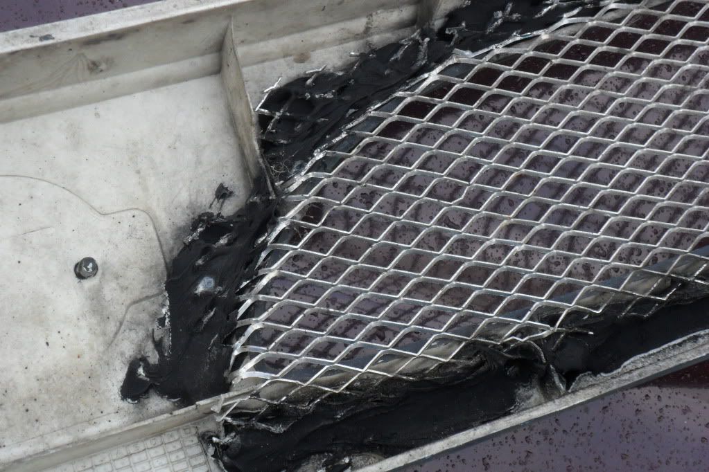

Pics from the back as promised matey (Y).. Horrible method and bad job, but the mesh doesnt move at all, and from the front, noone will ever know unless you tell them :laugh: haha.
The mesh has been bent to fit around the plastic as ya can see, then stuck in place with that black mess:
Easy to do at least, saves alot of effort with more fibreglass and screws i suppose :D
Good luck with it mate (Y)
that look preety much what i want to do something quick easy and hell its at the back nobody sees that bit but me anyway lmfao :p that black stuff where can i get that from :p do my local halfrauds have any :p

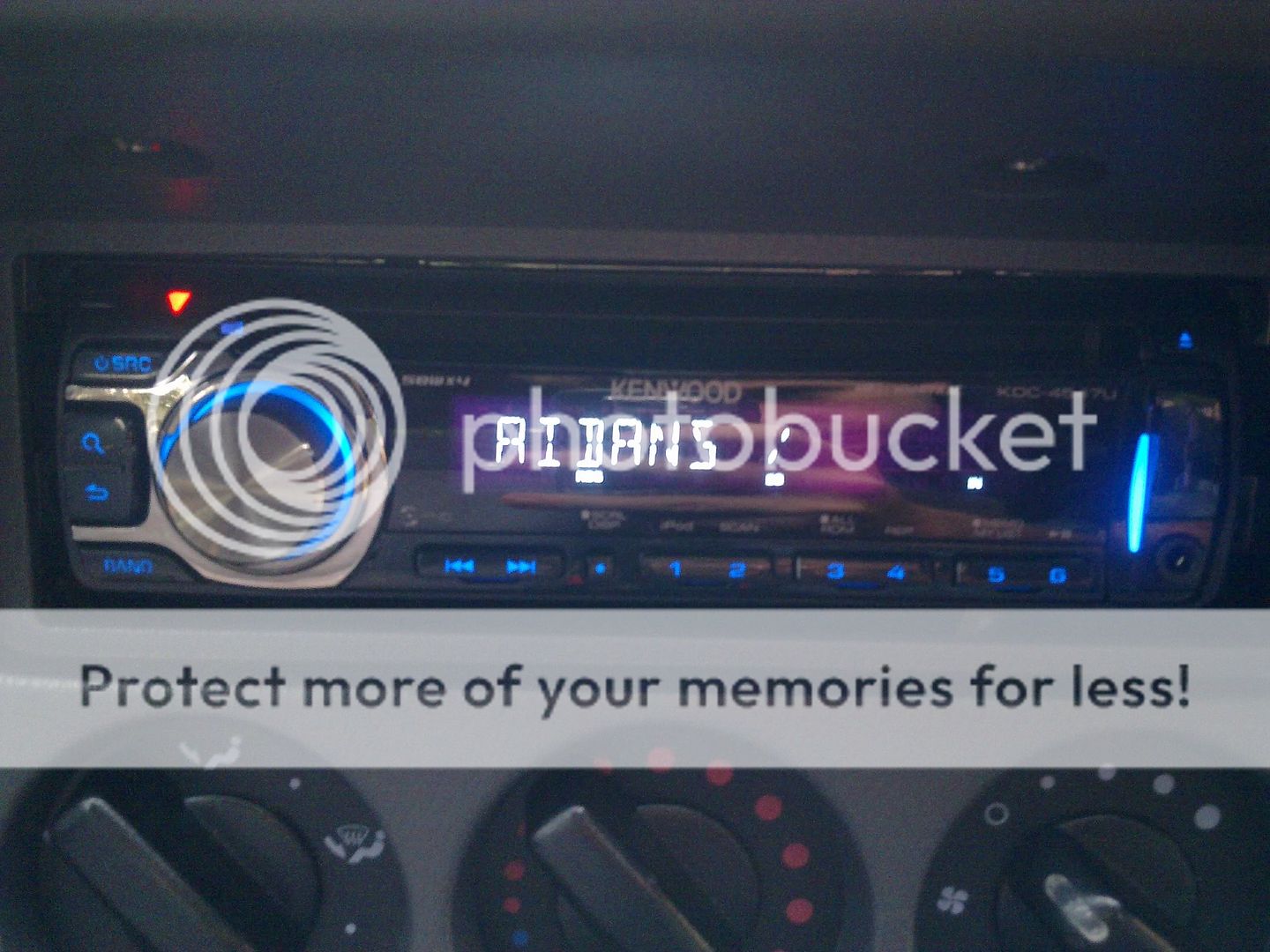

head unit :)

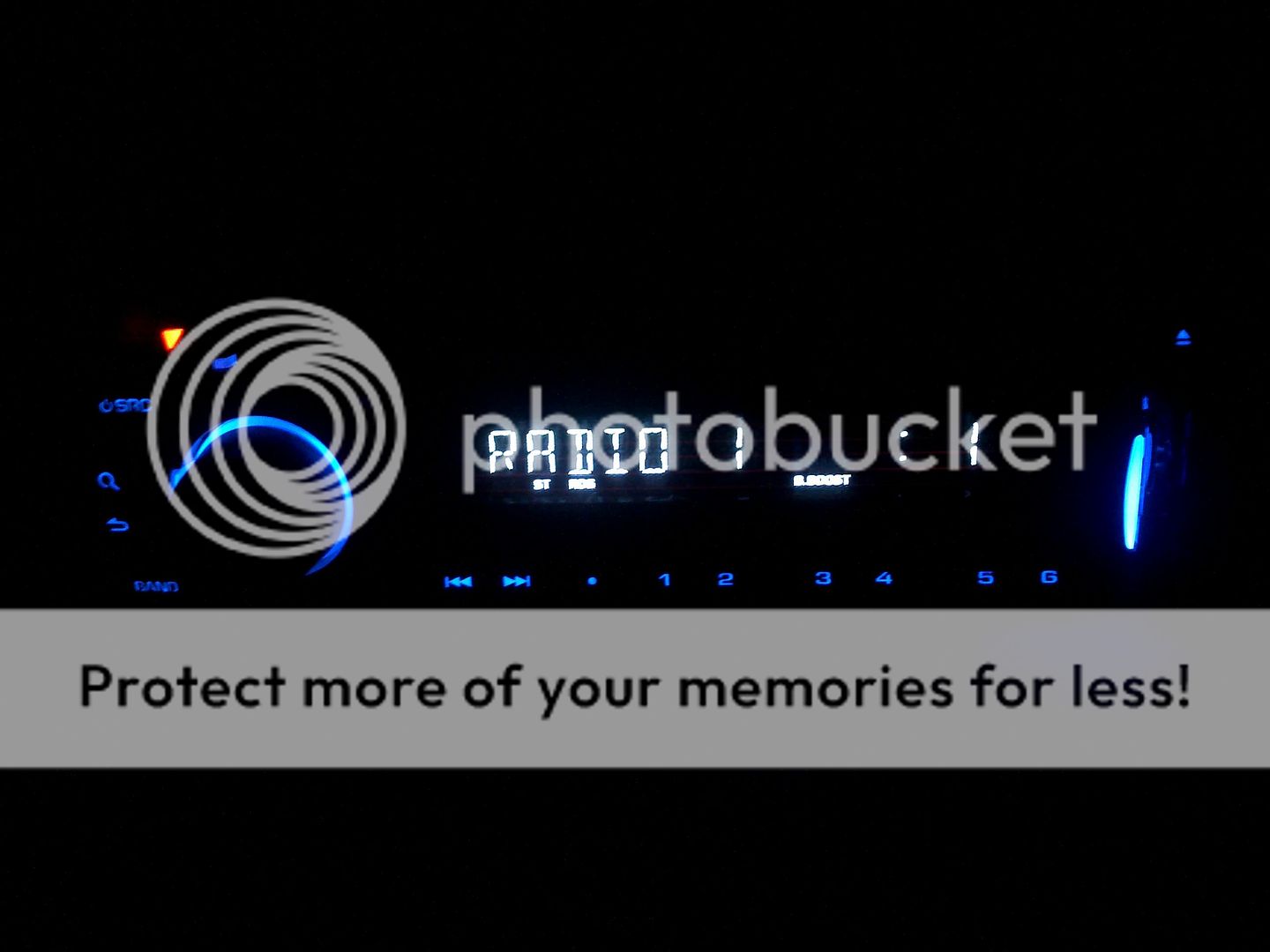

head unit in the dark ;)

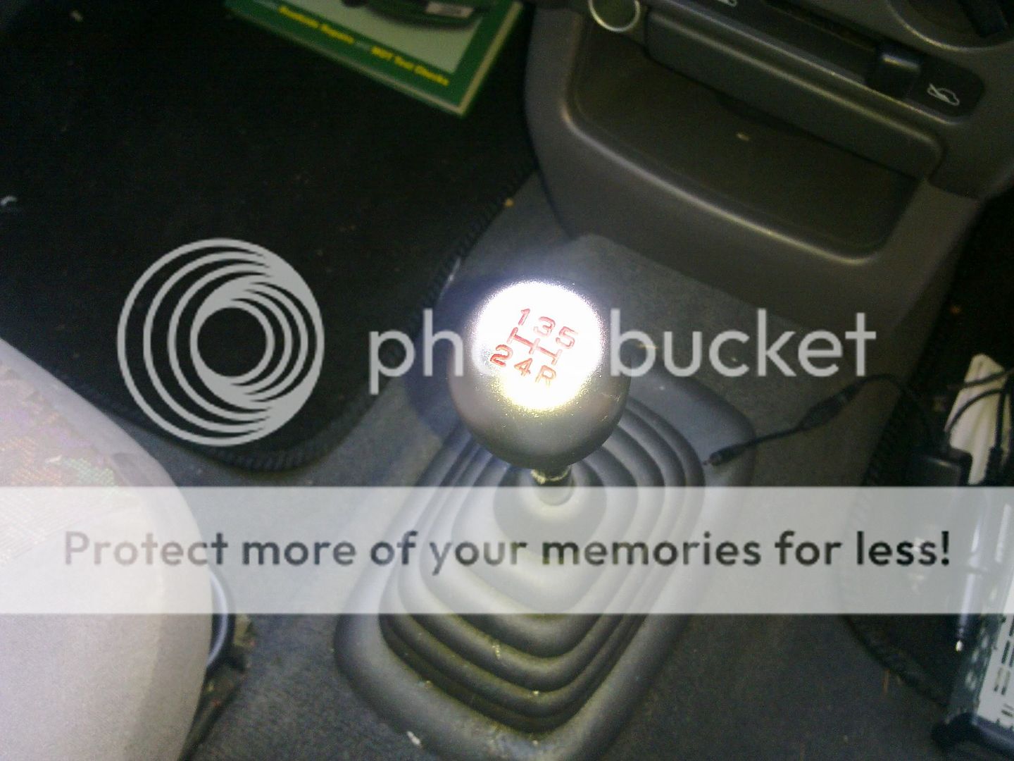

new gear nob :)

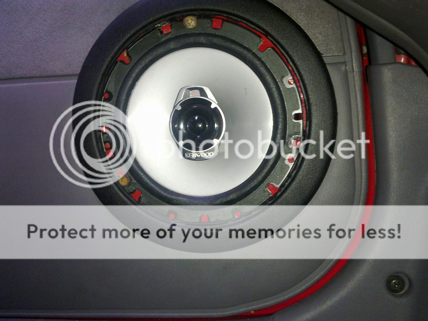

one of my new speakers (passengers side)

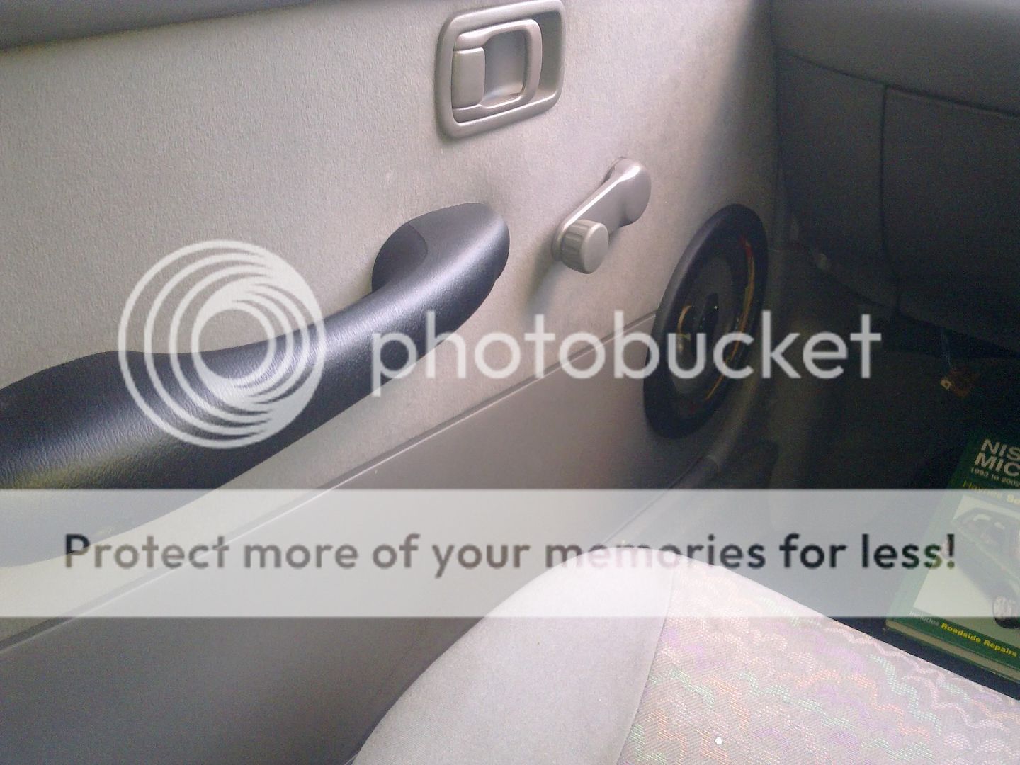

passengers door with sprayed handle :)

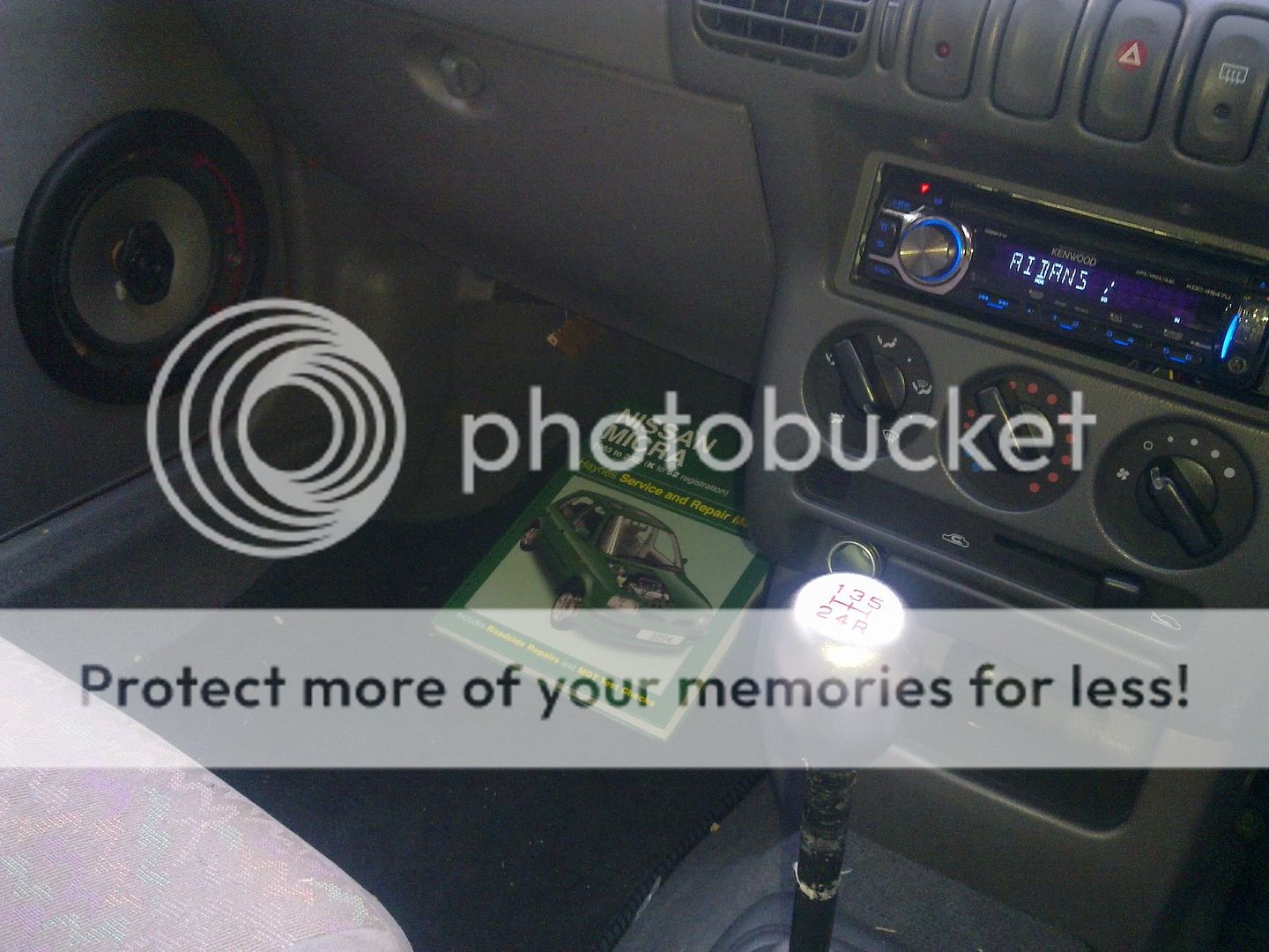

and this is just a little bit of everythin ;P
just to add the speakers look a bit different now with new screws in tht are shiny :p not got an updated pic did it today but was ina ruch and dint get any pics sorry :p
Good to see my old head unit, speakers, and gearknob on your car (Y). Gearknob is a nice touch as well, found it very comfortable when it was on my Micra
haha yer its really nice quite smooth :p sadly cant drive my micra till i can afford to insure it im just hoping it dosent rot past being moted lol :p
