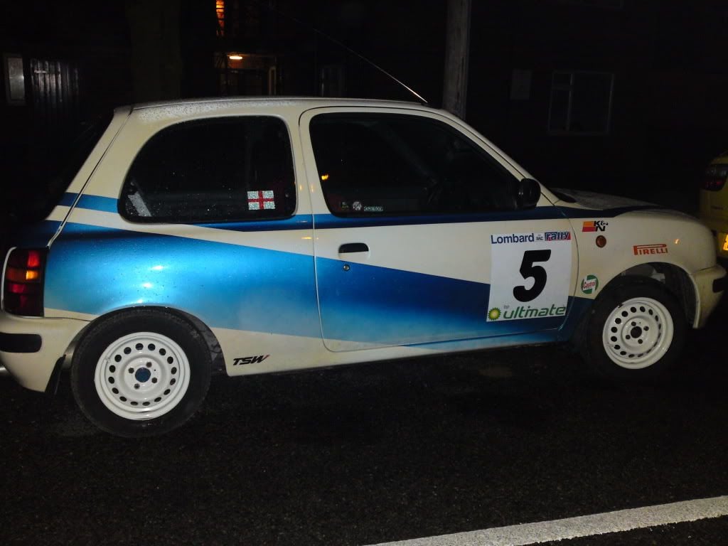

The car is basically standard, you can see most of the mods. It has a pair of cut rear springs.
The first thing I wanted to sort was the lack of acceleration. Thos tyres are 175 65 14, way too big and spoil the gear ratio. So I bought and painted a set of standard wheels and tyres, 155 70 13 these were part worn Tigar and Firestone F590's which I put on the back. While I was at it I painted the calipers and drums, blue of course!
