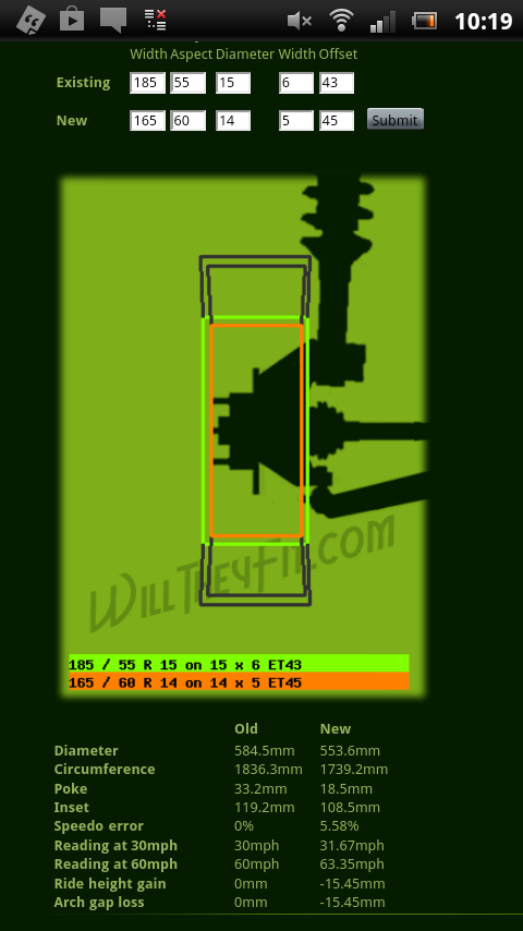

Could try www.willtheyfit.com or just draw it out on a peice of paper and measure the difference.
Cheers Mark, that's the site I was looking for! Still no clearer though, anybody else have any ideas?
Hopefully the picture above worked as I'm on my mobile... Is it the difference in poke that will equal the size of spacer I need (14.7mm) or am I barking up the wrong tree? Not bothered about the wheel face being in the exact same place in the arch as the other wheels (if that makes sense?) just want to clear the caliper...
If you need to clear the caliper the important measurement is the wheel mounting face to the part of the wheel that fouls the caliper - the offset is relative to the wheel centerline so doesn't tell you this, its all down to the shape of the wheel. As you say, 15mm brings the wheel face back to where it was. This might do the job fit you out it might not. You either need to get that measurement from the two different wheels and make up the difference with a spacer or experiment with different thicknesses til it works.
