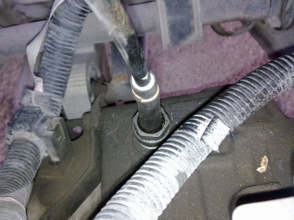

The above photo is where to 'nut/'connector' stops from sliding any further down therefore missing the grooves..

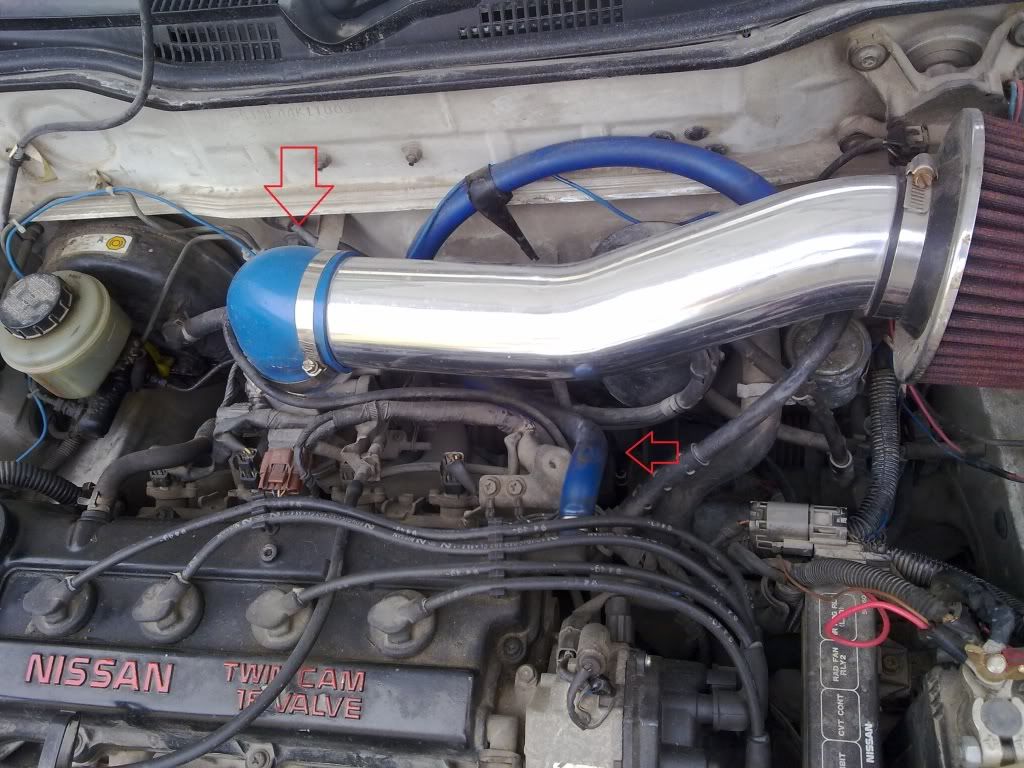

the above pic is for your reference to recognize which cable I'm referring to...I mistook it for the clutch cable....

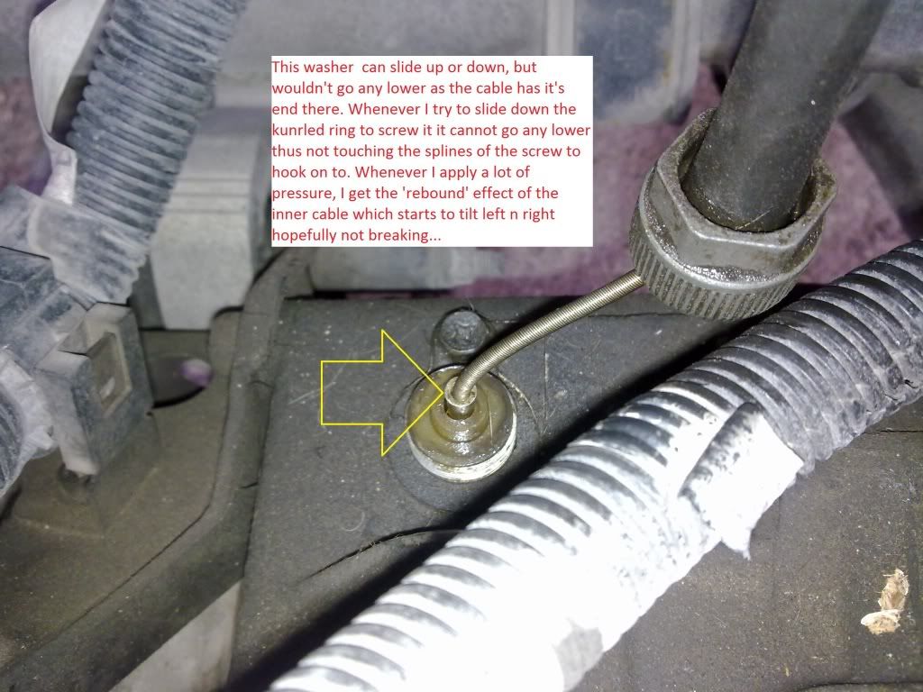

this is the parts I was referring to, noticeably the nut can be pulled further up exposing the inner cable. the metal washer is shown by the yellow arrow which stops couple of mm's higher than the plastic washer below. Both can be slided upwards towards the 'nut'. As they are I presume to be in place. the prob once again is when sliding the nut over everything to screw it back on.. it is simply stopping higher than the grooves.
