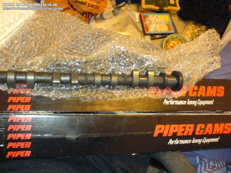

Cam-wise, you can go for a few, the names of most of them escape me right now, although I got some Piper Ultimate Road Cams off ebay for £108 for my 130bhp 1.3 project :)
I'm sure others on here can help more, but hopefully this gives you a bit of insight into the world of Micras and tuning them :)
