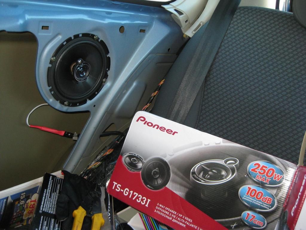

In last autumn I upgraded original speakers to Pioneer TS-G1723i 17cm 6.5" 3-way in rear, Pioneer TS-G1722i 17cm 6.5" 2-way front ones will follow when weather warms up in here. At same time I started sound proofing of noisy rear section in these vehicles, but yearly winter season with cold weather interrupted it. So whole winter time I had tiny Micra van, cause I removed back seat and interior rear side panels in order to do sound proofing :) Miraculously spacious van, when rear seat is off.
In addition on left side under drives seat nestles Pioneer TS-WX120A Active Subwoofer 150 Watt, I made a base for it from wood and this way it stays in place with out screws. Enough of sound system improvement to my preference & wallet :rolleyes:
Under rear speakers I made anti rattle rings from 20mm plywood, old trick to get rid of rattle noises after new speakers have been installed. They reinforce speaker surroundings when speakers-thin body metal-plywood bolted all together.

In front, remove door panels => change connectors, original on wire harness connectors doesn't work => make adapters for speakers => bolt & connect => Install door panels back.
Repeat in rear and you are done.

160SR's do have wiring/speakers on rear by Nissan, you need to inspect do you have rear wires.

You have 4 speakers installed to your Micra vehicle by Nissan.
Just find speakers/cables and change connectors to connect them to your replacement speakers.
