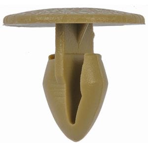

Starting from the bottom two corners of the doorcard, pull AWAY from the door about 1-2 inches to undo the clips and work your way around the door card. You shouldn't need much strength to undo the clips.
The clips look something like this (side view). I just grabbed a pic off Google, but it should give you an idea.
