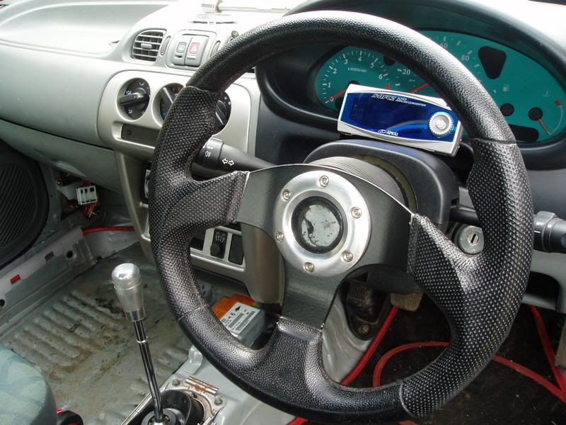

some more mods to my micra.
CMF_squarepants
» CMF Member
Member since:
Posts:
harness

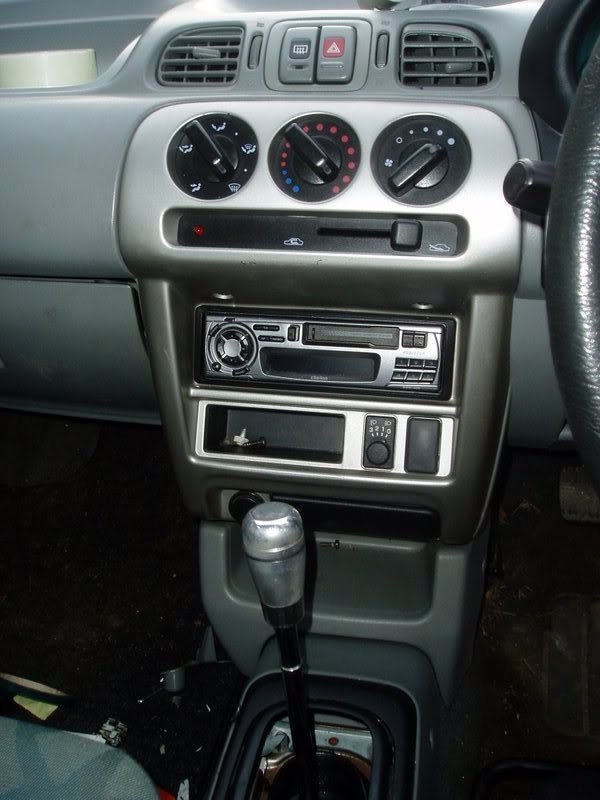

re-located swoosh tacho
k11 2000+ centre console (silver std insted of black)
the shocker :p

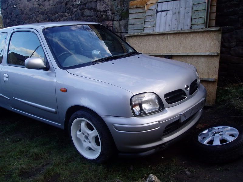

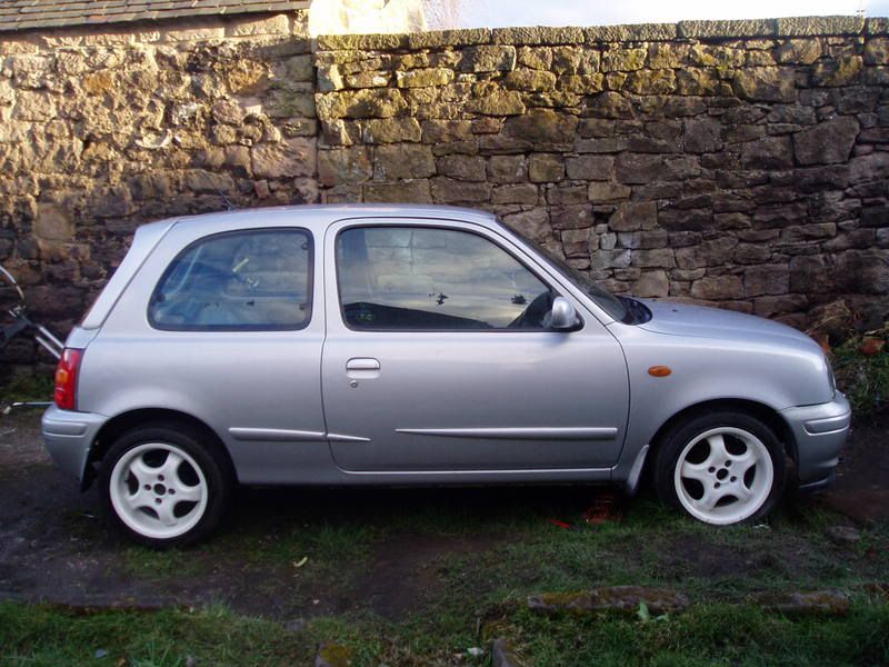

and painted my wheels from athersite to white! also put my unknown :s lightweight wheel nuts on there.

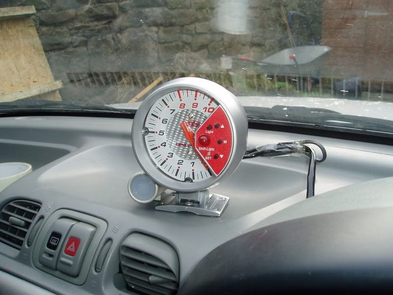

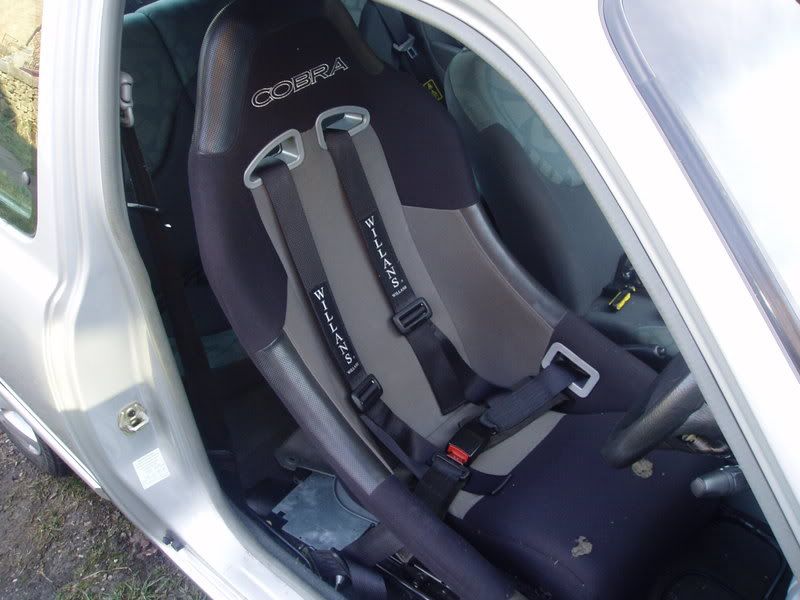

love the white wheels and the seats how did you put them in was it difficult do you sit much higher..... Not a fan of the big monsta tacho i think they are the ghey sex. But that is your car and looks sweet so keep it up
CMF_squarepants
» CMF Member
Member since:
Posts:
lol i thought the same about the tacho :p but its grown on me now...
the seat lines up with the standard seat subframe front bolts...but the rear bolts are out (welded abit of metal onto mine) otherwise its just bolted with 2 front bolts insted of 4! and is a abit dangeroues... also i think it depends on what seat you use. oh i sit near the same height as the std seat. the cobra is really comfy and you dont slide about like the std seat lol

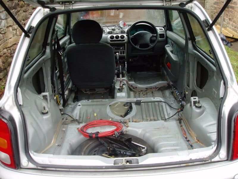

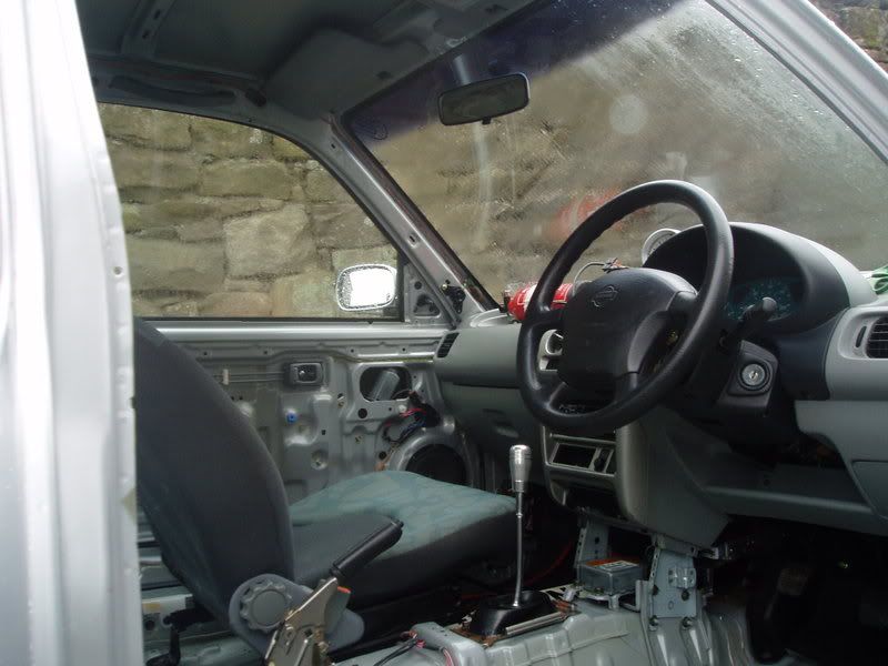

right...my interior is full of crap, so ive strated stripping it out fornt seats are out, and most of the plastic trim....when i get time iam gonna finish the job! hopefully this week if iam not busy, hope iam not :(

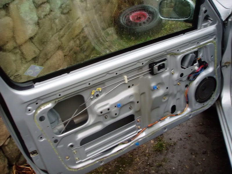

full interior strip... need pics tho, my cam is dead so will try and get some this week. also got my whiteline strut brace to be sent to me, then its bye bye electric windows! in come some lower spec winder units! and prefacelift door cards (as there way lighter!) then plastic windows :p
CMF_squarepants
» CMF Member
Member since:
Posts:

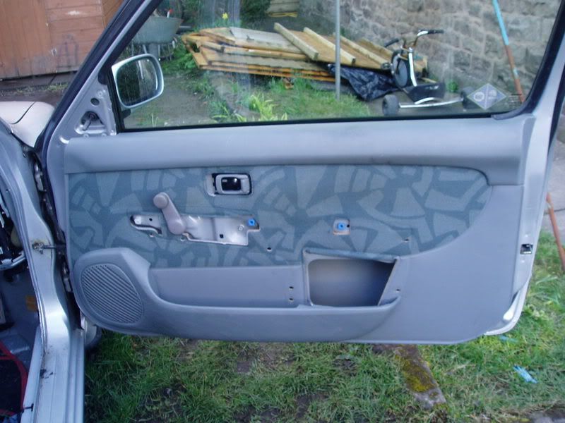

just the motor (well the sizzor thing lol)and obv the door cards there just a straight swap...
decided to keep my electric windows now, when there wouldnt be a noticeable diffrance. my plan is to blank off the pass door card and have both door cards in thin metal or carbon sheet, keep my drivers arm rest inc switchs, and get a lower spec arm rest with out window switchs.

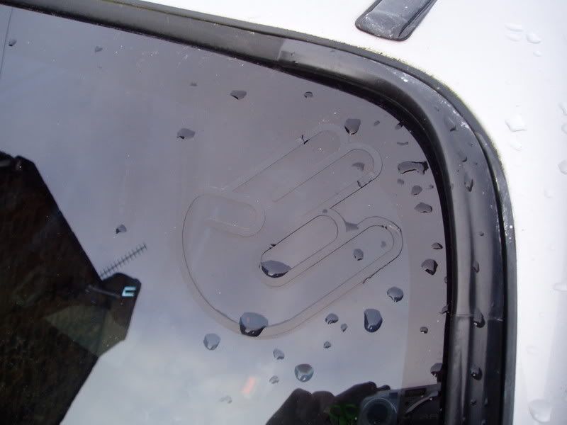

also, will be getting some perspex windows....got told yesterday by a friend he knows someone who will replecate my windows onto plastic... near £10 a window. if not less! as he charged my friend £10 for a big sheet to fix his next door neighbours green house!

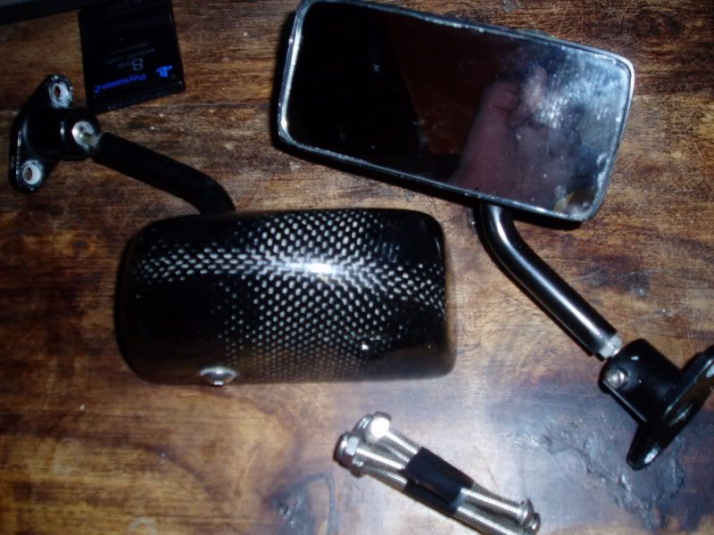

my carbon mirrors :)

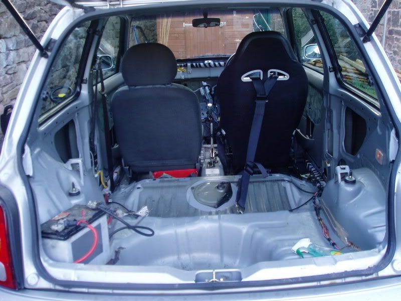

put my heatrs back in now lol.... has window winders insted of electric motors now aswell! you might think iam mad! but i preffer them :S plus i thought they would weight less than electric ones but theres not even a notice weight diffrance when you hold them in your hand! so was abit annoyed the fact i spent £15 on them to be no diffrent!

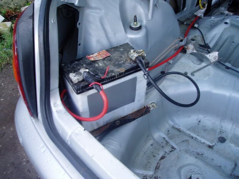

also re-locted my battery to the boot this afternoon, gonna put my kill switch in when i get time aswell (put it up front, below the dash i think?) :)
as for losing weight, been to the scrapyard and got fixed rear 1/4 rubber seals (i have pop outs) so gonna get some perspex rear 1/4 and front side windows made up!.....
reason i wanted them fixed is because i dont think pop outs would be strong engough to be made out of perspex they might bow with the wind etc?
tbh i think ive done everything i can to lose weight without making it a track car! trying to keep it good for everyday useage! .....

"turbo march-rolling shell WROTE:<BR><BR>DIV&gt;<BR><BR>and safer! it looks pretty 2nd hand.. wouldn't wana be wiping acid of my face if it exploded for whateva reason :("</DIV><BR><BR>yeh true. i thought if it was a non sealed battery it has to be in a battery box?
yeh, then it has to have a vent to the outside somehow, r33 skylines run a battery in the boot with a small hose coming of them that exit above the fuel tank to the atmosphere underneath the car, so i spose you could do a similar setup to that, or just get a sealed battery :D!
CMF_squarepants
» CMF Member
Member since:
Posts:
i have a battery box beeing made up by a friend, it sits over the battery and tray, with some L brackets/legs that bolt to the floor.... i wouldnt mind a sealed half size battery but there expensive! when i get the cash iam considering buying one, but this will do for now!

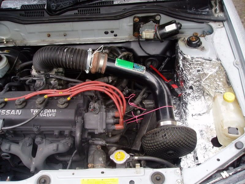

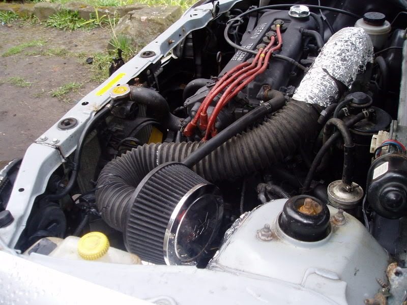

re-located air filter....
just put foil around where it sits to keep the hot air out near that area. not the best job i know but o well :s

Make sure the battery is very very well bolted down. If you have the unfortunate experience of a crash, that battery will do a lot of damage if it breaks loose.
CMF_squarepants
» CMF Member
Member since:
Posts:
lol it aint been boltted down properly yet :s the battery tray is held in with one bolt..., it rocks about as its only half one the flat floor and the rest is on a slight dip that goes into the spare wheel well! so the battery tray tilts and moves! need to do some drilling....plus my box will help keep the lot in place in the event of a crash.

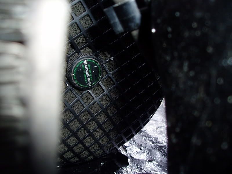

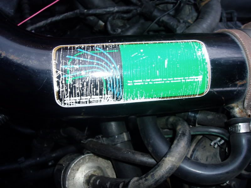

well screw the k&n lol ive just got a genuine HKS filter! came from an import mr2! got it for £15 inc the piping! just needs a replace-ment sponge!
dont know what this means? looks like a tourque graph or somthing lol? could mean hks tourqe filter? or hks power filter?? :s

hay... just to improve it again.. put an oil catch can on the the oil vapour line from the head to the cleaner(oil vapour kills octane levels)...... and a bit of a heat shield to divert the radiator exit air away from the intake. Its looking good!

hmmm, oil catch can never really thought about that pal! hmmm think i will pop in to my local motor factors and get one and just stick it between in the pipe line!
plus good spotting! i would never of thought to wrap the rad pipe up! lol only just noticed that its sat in-front of my filter! cheers for the help ;)

yep iam sure its lowered lol! it used to sit high on the rear with all the interior in never mind with it stripped! to me they only seem like 30mm springs but meh! iam only bothered about the stiffness of them not the looks! fuction over form!
i love the intake! way better than sat on top of the throttle body!
yep i love the foil lol....bettween you and me it hides a BIG paint fook up :s lol shhhhhhh

my new wheel, painted matt black.... the k10 super s one was too big like driving a bus! so banished that one to the shed....iam tempted with power steering now tho lol
