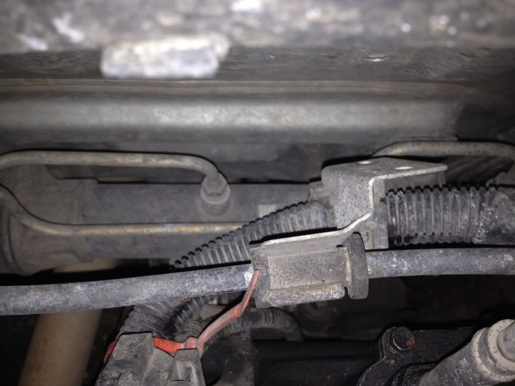

It was the actual metal bit that goes onto the pedal that let go
this bit frank
