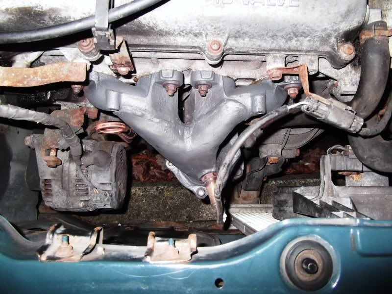

It could be a faulty lambda sensor and is reading irratically and putting more fuel in. May just be a dirty MAF, trying cleaning it with some carb cleaner.
Assuming you have a K11 then ^^^ its in the throttle body. So just remove the airbox and squirt some carb cleaner down into it.
The lambda sensor is located on the exhaust manifold.
The plug there on the front leads to the sensor.
I would clean the MAF first, alot easier than having to remove the lambda sensor to only realise theres nothing wrong with it
Thanks a lot man. Right now I'm just going to assume that it's a fuel leak,since it's the most obvious problem. If that's not the case I'll bear this in mind. Even if none of what you guys are suggesting is part of my problem, I've at least learnt a few things that might be of help in the future. So thank you all. Picture was very helpful. Way easier than trying to explain a metal thing amidst a collection of metal things :laugh:
