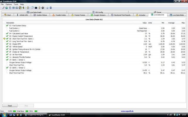

you sure theres 2 i can only see the 1 and the diagnostics says theres only 1, well im only getting readings/info for 1
well im blind:eek: , there is readings for both sensors on the diagnostics program, only thing is all these readings mean nothing to me dont know what im looking for
with front sensor plugged in
with front sensor unplugged
so is this gonna be something serious/expensive to fix, as its 99% wether its plugged in or not.

i get .5v when its idle when fully warm but goes to 0.0 when revved
wide open throttle mate, and it should bounce between .4 and .7v every second or more if its closed looping properly
cheers will double check tomoz the wot,
i dont think its going into closed loop atall, on the diagnostics it never says closed loop, just open loop then when revved a few times, says open loop fault:confused:
cant find my multimeter so cant get readings direct off the o2 sensor but have been out in car with diagnostics to get voltage readings and when driving its 0.00v and when you let it idle it fluctuates between 0.460v-0.560v and nothing at wot either.
in the section where is says what loop its in it says open loop and then whilst driving it says open loop due to driving conditions, never goes in to closed loop.
so very confused, readings from sensor at idle just not when you touch throttle or drive
