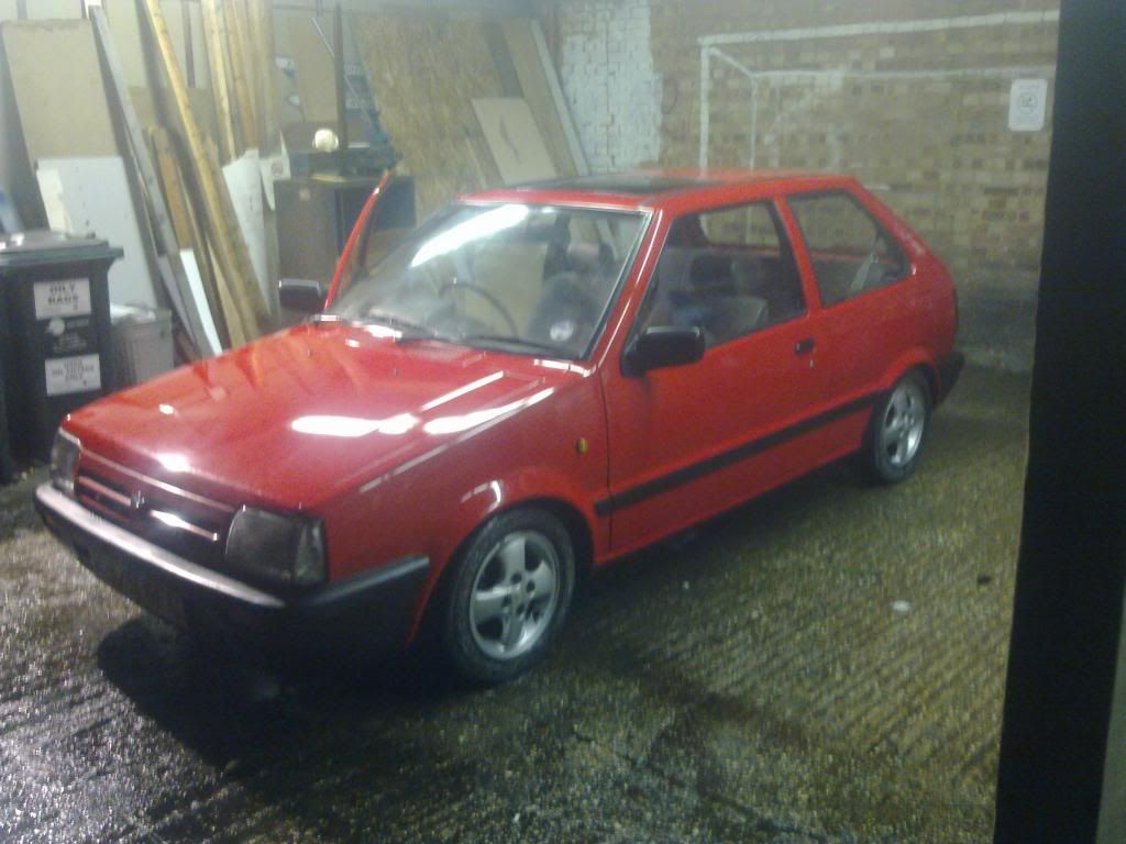

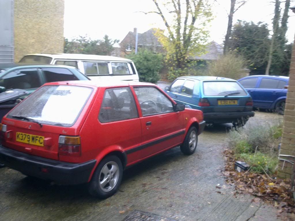

So this is now my third micra a nice little base spec 4 speed k10
I haven't done much to it yet but;
Striped out all of the sound deadening
k11 1.0 front dampers with some k11 cut springs
k10 front springs cut in the rears
Polybushed rear damper mounts to the body, this pretty much stopped all the bouncing from the cut springs in the back. 90 shore D pretty strong stuff
K11 Sr alloys
Gonna try and fit most of k11 front suspension, brakes and steering rack but that will probably come in time.
Its got 80k and seems to have very little rust on it, 2 owners and guy before me had it since '94 so he must have looked after it, the interior is mint too
