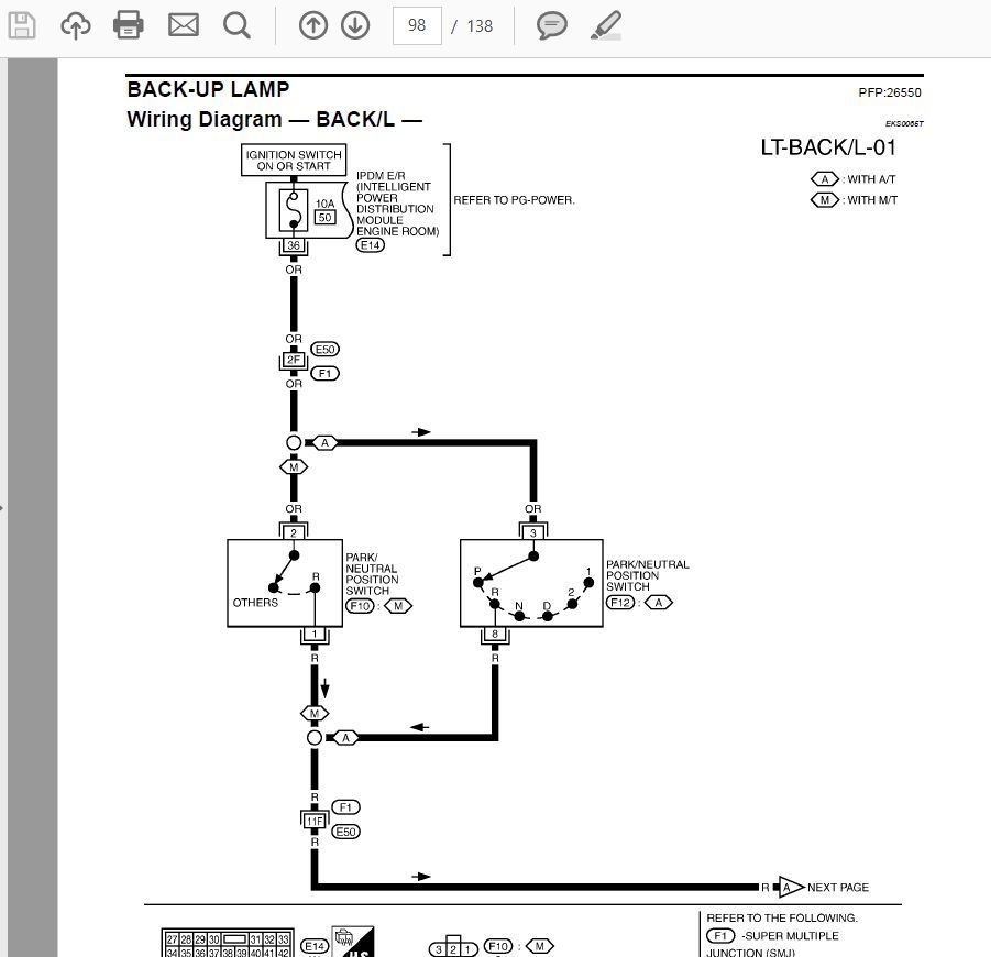

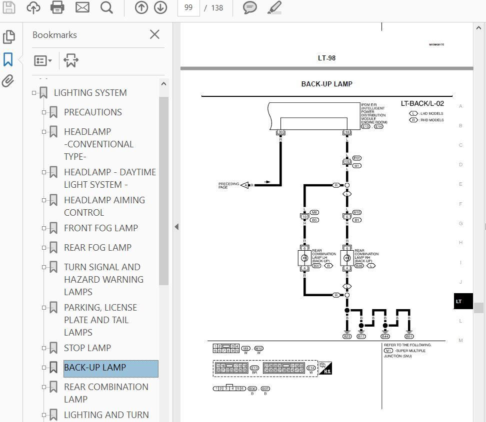

circuit information here:-
As the final power switching is via the 'intelligent power distribution module' you may well find that disconnecting the battery and then reconnecting it will fix the problem. I recently had a similar problem with the rear screen wiper that stopped working and was switched through the IPDM and this cured the problem....
