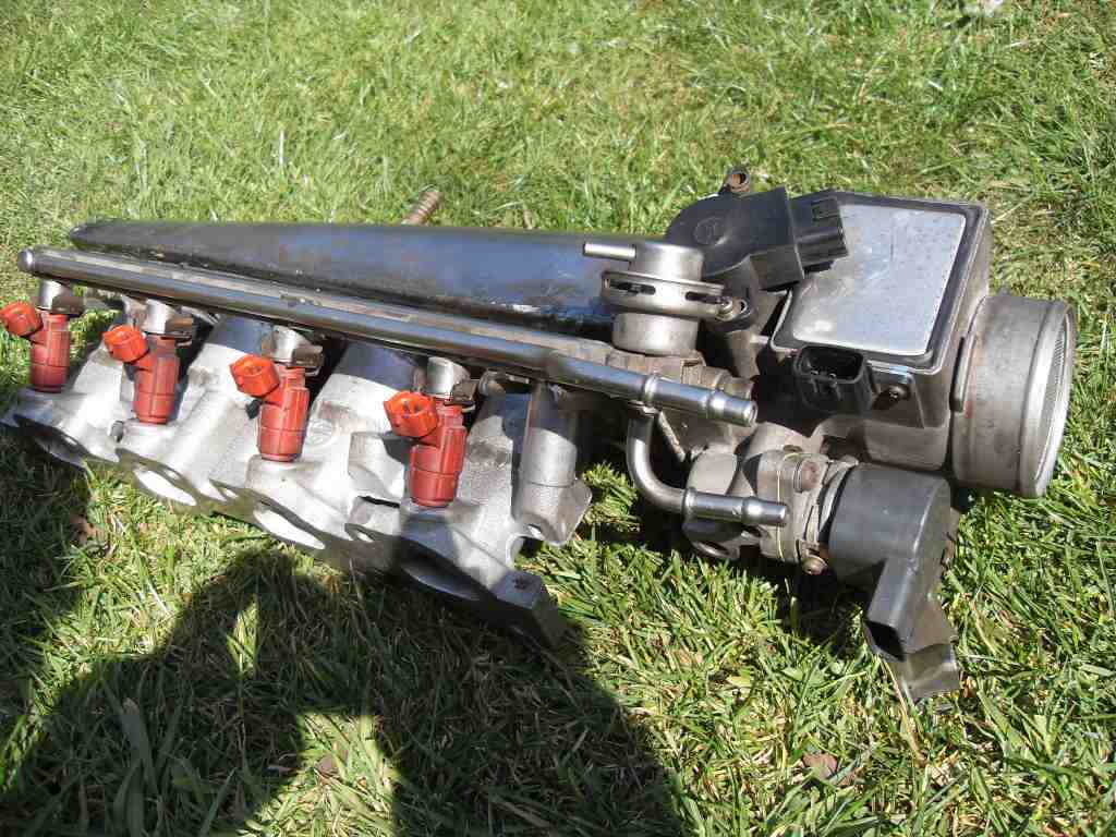

Ahh man, that's allot of effort to raise my rev limiter that litter bit, Are there any injectors that I can put in that don't require any modification, such as almera 1.6 one or something? and what sort of Gains would I get from increasing the injector size? also AJC do you have any pictures of your fuel rail and your fuel pressure regulator?
No the SR20 ones are squat fat things and have a different fitment to the rail, these are longer and thinner and a direct replacement. I got the reds really for when i get the turbo on. I noticed a very slight increase through the rev range, but more so at the top end, not much to write home about tbh, but it did make the response a bit better on gear change, and i run lower than normal pressure, as i said i think this may be why i get a higher rev range, i havent had time to test this yet tho. My reg is one of the 15quid universal ebay ones mate, very easy to fit, took me about 20 mins.
Do you have any pictures of the FPR fitted? and is it literally remove old connect up new? ITs a cheap mod that might make a difference to the way the car feels and maybe even better fuel economy ;)

65895-jpg.22333
As frank said, very straight forward to fit. I doubt you will get any better economy tho tbh with bigger injectors, unless you drop the pressure right down, then it becomes counter intuitive, as i only do 50-60 miles a week i aint all that bothered by economy, that said its prob only a matter of a few MPG if that i lose
I have a pic of it fitted but tbh, its not much to see, as you can see (ignore the 3 bar pressure, its on fast idle, normal pressure is 2.5 bar)
