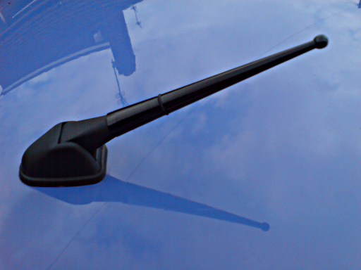

My Micra's aerial (2001 1.0 Y plate) was snapped off by vandals a few years back, it was like the type in this picture (I've linked a random advert on auto trader with the same type, this isn't my car)

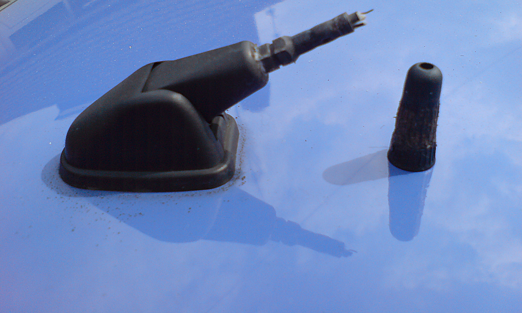

ok, I've taken a macro photo now this morning.
With the cap removed (right), you can see the bolt with the core of the wire through the middle. The cap is a push on fit rather than a screw thread, I guess it was glued also as I had to use grips on it to get it off. Will these replacement aerials with included adapters fit do you think?
Looks like a replacement ariel should fit. Can you unscrew the bottom-most bolt? I think that might be your answer (Y)
ok, thanks. I've not tried to unscrew yet, it's difficult to see if the bolt is one or two sections, I didn't want to force it and damage the core before checking what I'm doing. I guess these adapters will need to screw in place of this bolt?
It looks like it might be 2 sections, but can't be sure. Just spray a bit of GT85 or WD40 onto it, should loosen it up a bit if it's too tight. Should just come straight off, and then the adapter (normally comes with quite a few) should just screw straight in where the bolt came out (Y)

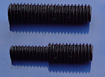

I fitted the aerial successfully this morning :grinning: I'll post a couple of photos later on of the fixing... the bolt was just one section in the end and screws off at the base. It didn't want to budge with grips even after spraying it with wd40 so I'd advise using a small spanner as I did in the end which makes the job extremely easy to do.
ok, so here's the photos...
Here's the original aerial bolt now it's removed.
The new aerial comes with two bolts, I used the one with the small thread.
...and the aerial itself just screws onto the new bolt. Simple! takes about two minutes.
