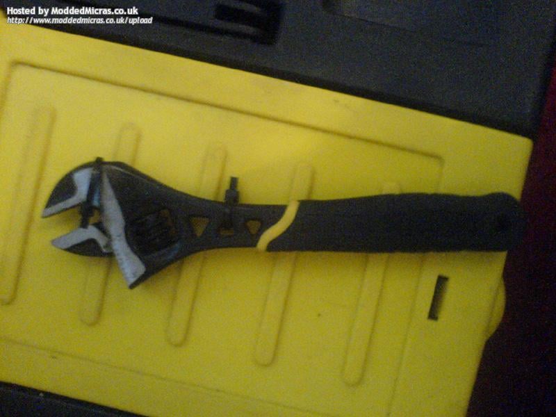

Im having some problems removing the rear shocks. I know that your meant to hold the pin bit still whilst turning the nut, however i havent got anything that'l grip the pin bit well enough! Can anyone recommend anything? or is there a specific tool for keeping something still whilst turning something else.
I tried pliers and other things but they're all crap!
Any advice appreciated :)
what are you doing are you changing the shocks for new ones if so when i do it either a good set of mole grips or cut through the old shock stem.
just remember if you cut through make sure be car is jack up so the back wheels are off the ground and no tension is on the spring,,,
They're being removed and fitted to Ems K10 instead of replaced, so cutting them off isnt an option! Cheers for the suggestions though, i'l try getting some mole grips or something
Right it's all good!! I went and bought one of these >>
and i've got one of them off. I'l do the other one later! think i might go back to frauds and buy a decent jack
