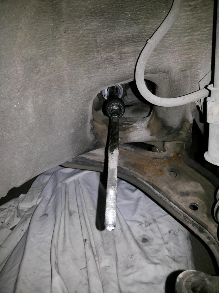

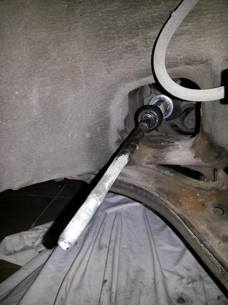

OK just wanted to make sure, I think Frank might be right. Have been planning for long to replace both inner and outer track/tie rod ends of my '95 k11 1.0L , now it seems I've hit a dead end with my inners since they seem all round and even worse seem to have no nut anywhere??
have had the replacement ones standing by for quite a while now waiting for me to get things done, now that I've started replacing them this evening *er have the car jacked up right now with the inner boot/gaiter removed *er seems like have hit a dead end and would need to put the gaiter back on and replace just the outer ones only... Photos maybe these would be of any help.
Above, is the inner tie rod end from looking from inside (steering rack looking outside towards the wheel)
This is the inner tie rod end as seen from outside. It has a round edge allover
Again

Above is the inner tie rod end, I guess it needs replacement, yet the way its fit the whole rack must be replaced. Any Opinions guys?

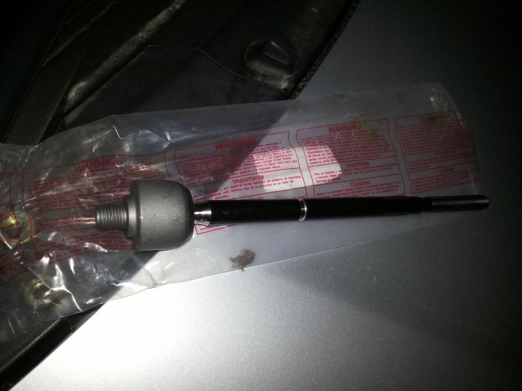

have a look at the replacement tie rod, does that have the flat hex/square edges?
thats odd that the current tie rod has no edge for any spanner/tool. try unscrewing it off with big mole grips. check for any locking pins/rivets
Firstly it seems like the rod is OK. Twists with mole grips off dudr. You need to look under the rack face for a little metal flap which will stop the rod unscrewing itself. I had to break mine by twisting the rod and forcing it as I twisted the rod.

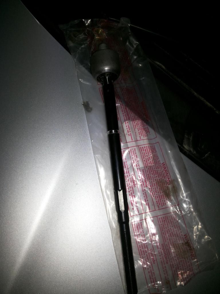

Youre right mate the new one has no flat hex edges anywhere. Just a thread behind the hub. Ill soon post a picture. But still am weary on how would I go around clamping the old one to try to undo it.
if you can find a way of securing the new one without damage, i'd grind flats onto the old one to get a spanner on it.

Here's a photo of the replacement inner which happens to be also round, but has a thread at least in the inner side. Have no clue if mine's liek that too, It would be risky trying to grab hold of the stock one whilst twisting might damage the rack if its unservicable and the rod gets bent...

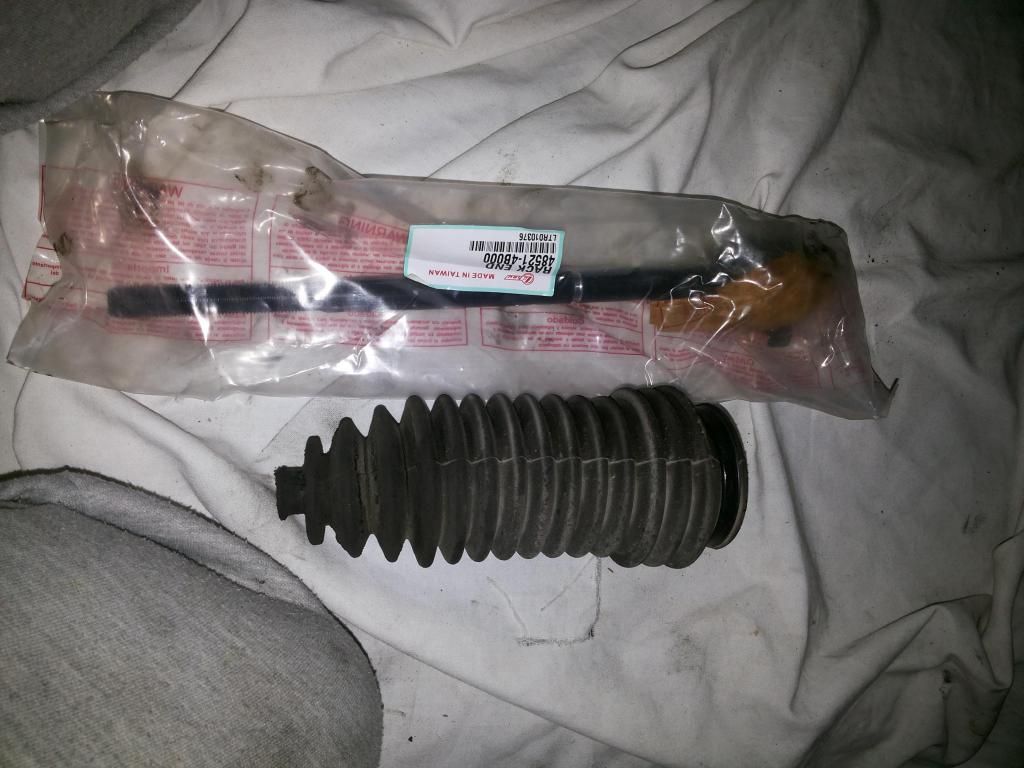

Both Inners only costed 21ish quid for the two off fleabay here's the immaculate seller's link: http://rover.ebay.com/rover/0/e1140...1&exe=10013&ext=100025sojTags=exe=exe,ext=ext
here,s the one from my old 95 super s, different (finer) thread, and serviceable type
Than mine's surely not serviceable since in the vid I posted there doesn't seem to be to part were the rod connects via a thread, just like the replacement has.. right? If I tried twisting use mole grip than I might be damaging the rack?
