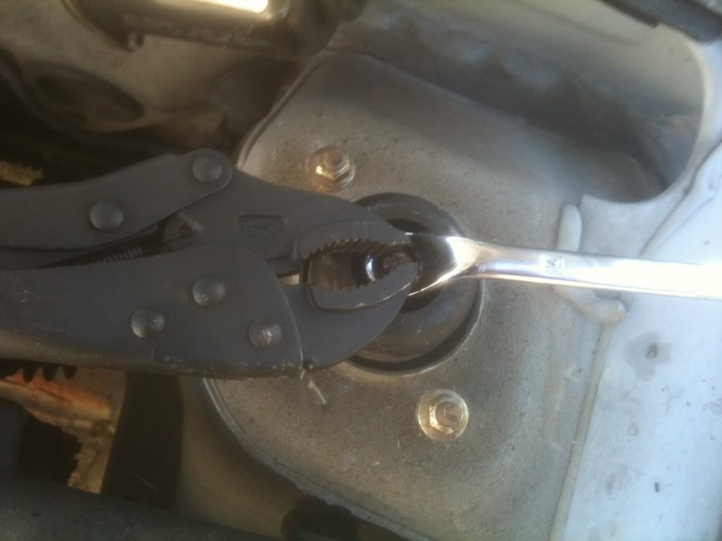

Try to loosen the top nut while the cars resting on its wheels so there's minimal load on the nut that can hinder removal. Need a swan neck o-spanner on the nut while securing the damper shaft with a close fitting c-spanner or adjustable spanner

Just had a quick attempt at loosening them nut but they just wont shift!! Mole grips on the center and 14mm swan neck spanner but no joy. Would compressing the springs beforehand help?
iv,e had to compress them and pull the sponge bumpstop down to get the molies onto the shaft sometimes wehey, it wont matter if you scratch the shaft there (but dont scratch the working/lower bit tho eh fwn

I presume i have this bit right
Try as hard as i may all i am doing is knackering the top of the rectangular bit. Both sides wont budge. Wheels are on the floor!
