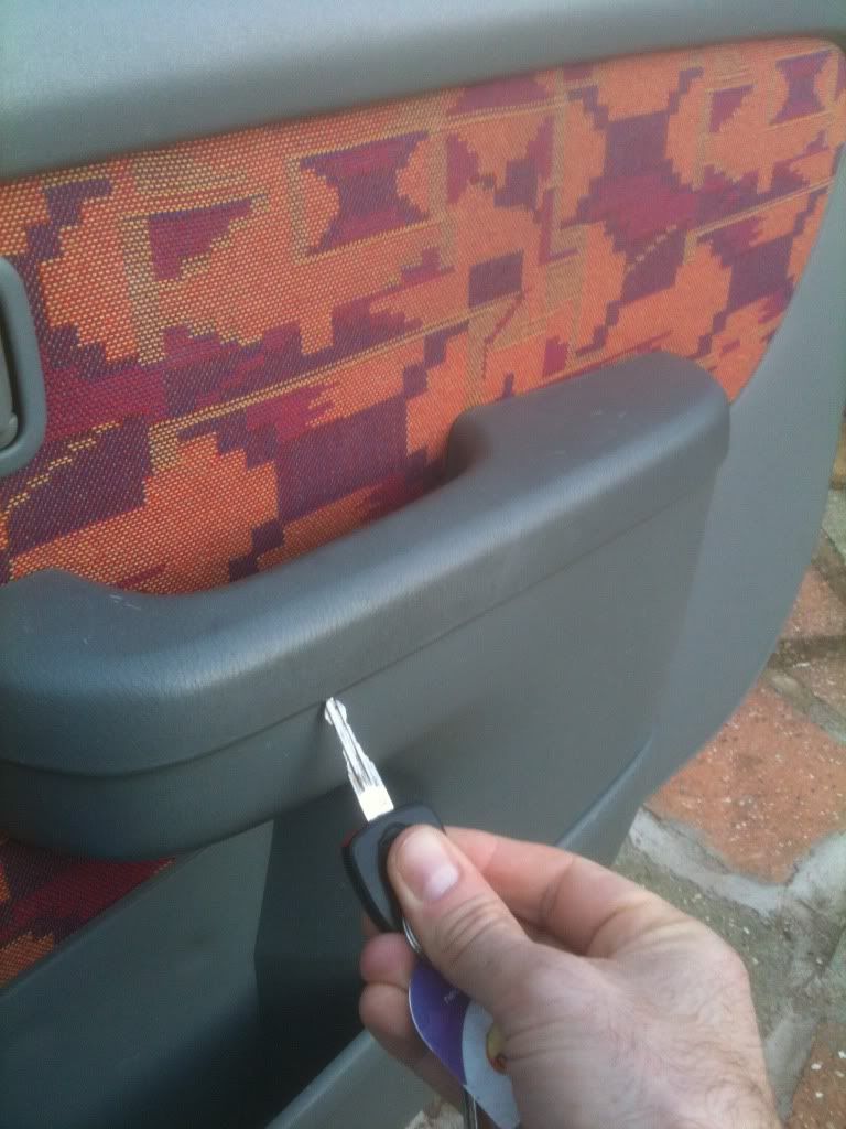

I had the same problem. There is a removable plastic piece that needs levering off to allow access to 2x screws
:glare: Thanks for the prompt reply wehey. But what plastic piece do I have to remove? The armrest it seems won't prise off, so that leaves the plastic part underneath it. Is this the part to lever off and if so, where do I start to lever it off from please.
Hopefully yours are the same as mine
(Y) Once again many thanks wehey for the swift reply and to top it all the photo. The photo of the door panel look's the same as it is on my car. I will have a go at removing the door panels again using your very clear info for the same. Will post back and let you know how I got on.
:laugh: Took a little force to pull the top part of the armrest off. But it's done and the new MAC audio speakers are now fitted after a little change of the wiring set up. All back together without any damage and the sound is great. Couldn't have done it without your input, so many thanks Wehey!
Excellent mate. Glad it worked out well :)
