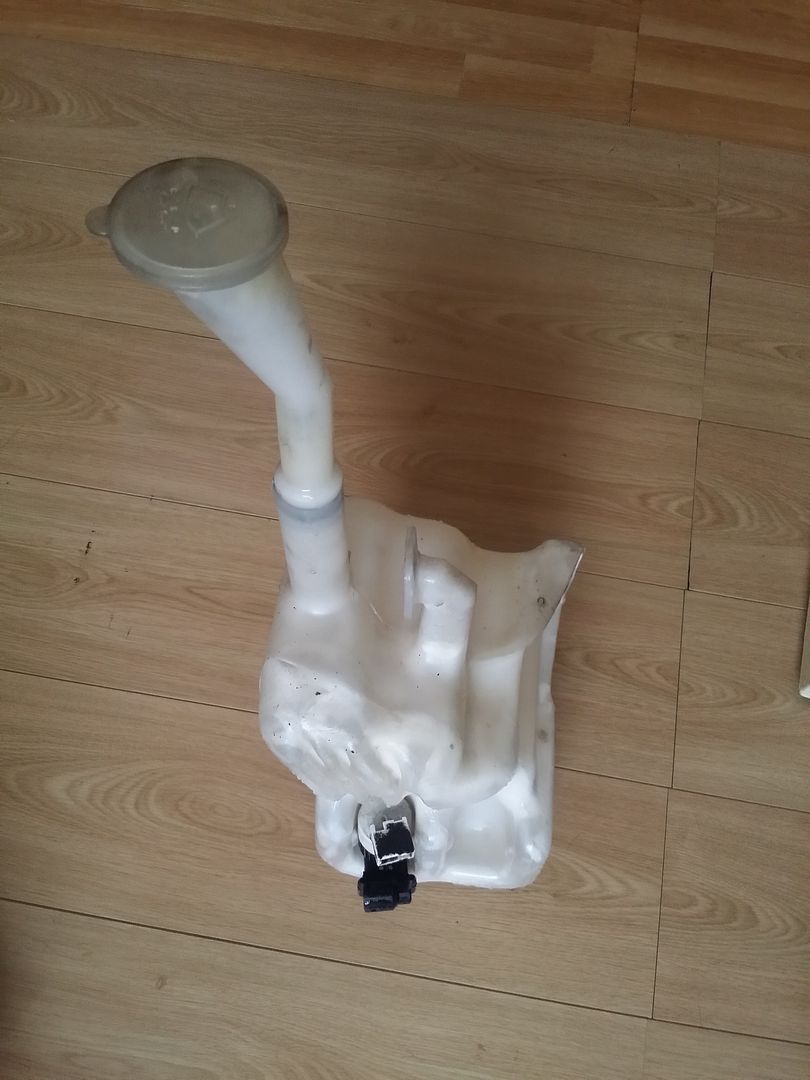

sometimes 2 pumps, and sometimes 1 reversible one :)
looks like a one pump here
[/URL]
Just came from the parking 15 min ago to test if my pump does not work, of it's electrical (lots of sh*t around, though) and i'm lucky, is electrical, 2 terminal, clack clack, shrink tube, aaand it's done!
