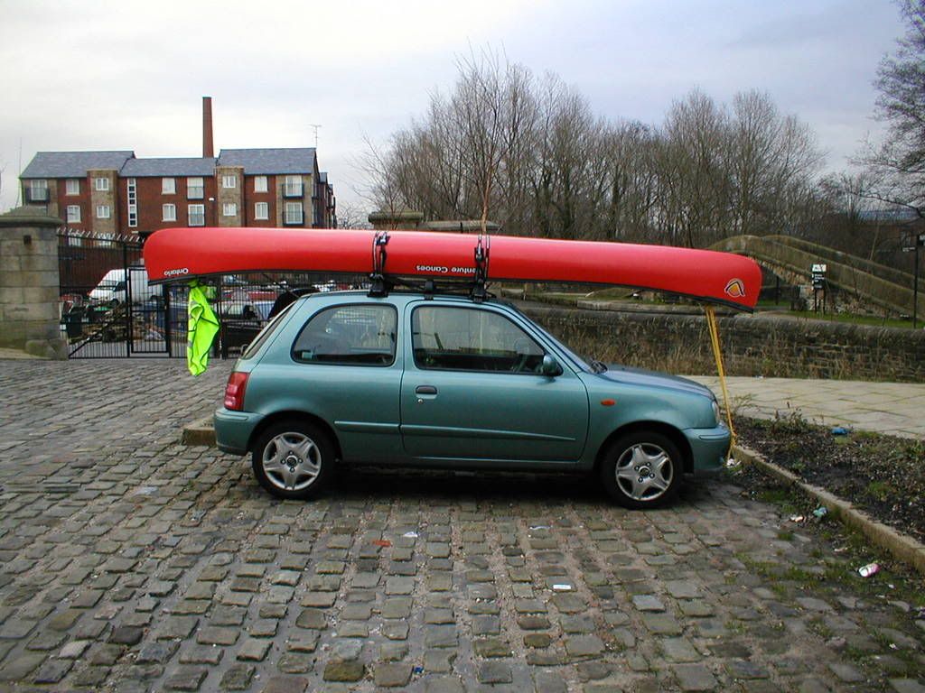

You can get roof bars for a 3 door k11 with fixed windows. I have looked into this extensively as I need to transport a kayak and a windsurf board.
There is a seller on eBay that does them for about £80 but I can't find any pics of it.
Also halfords do one but it costs near the £150 mark.!!
Let me know if you want any more details :)
This is similar to the halfords one
cheers ive found the rack in the picture for 130 just not sure if its stong enough:glare: gonna have to try and find some opening rear windows if not
