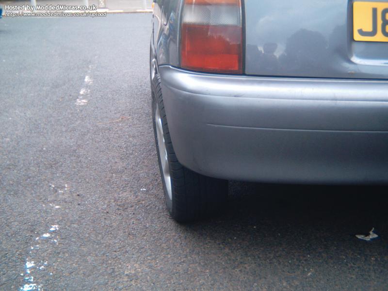

if the wheels are leaning out like that then its probably a bent axle, has the car been in an accident at all ? hit a kerb side on or something like that ?
do your wheels tilt like this ?
thats after I bent my axle.

cheers for the reply sonic,
yes it looks like that on bothsides of the back, but the angle isn't as steep.
I do suspect it been in an accident before I bought it, but nothing came up on the HPI check.
