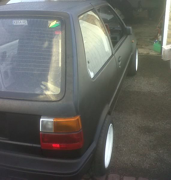

still waiting for pics. I have managed to flare the arches quite a bit on s12
before
after
