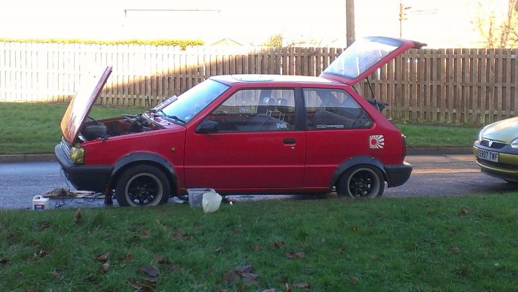

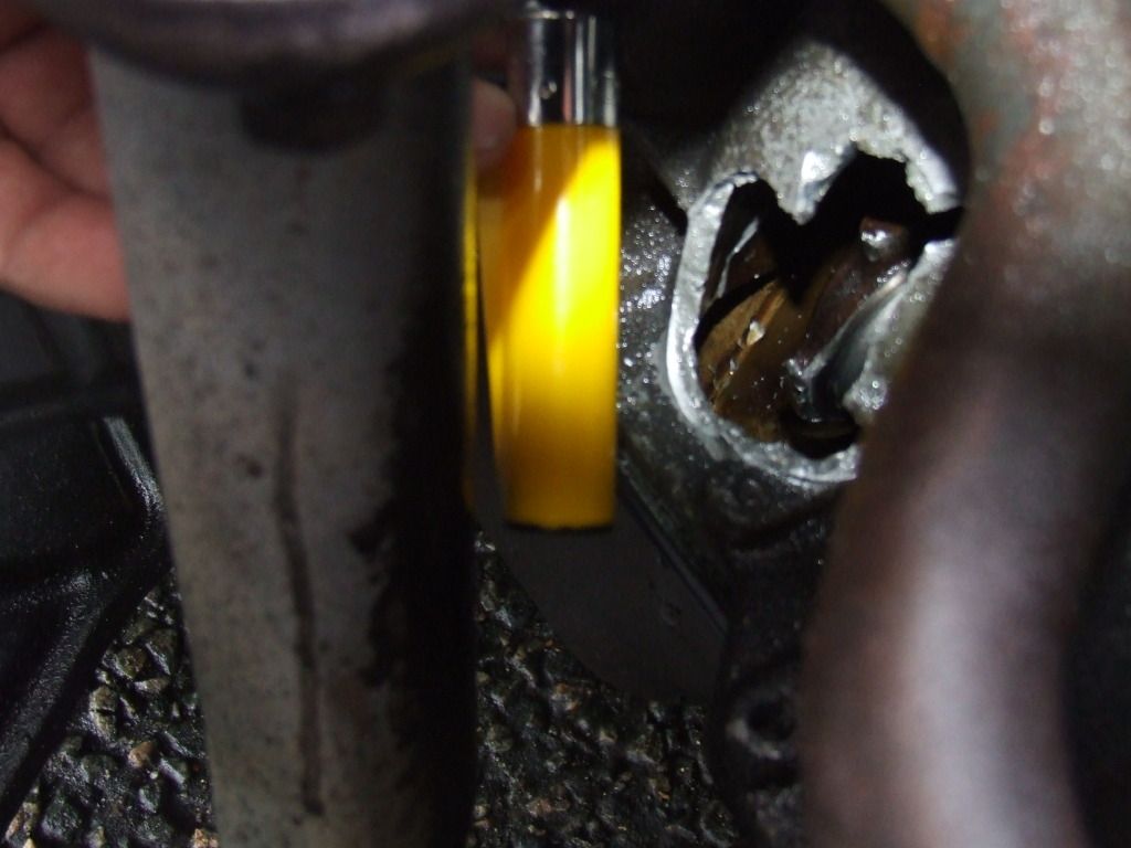

well as few of you may know i have owned pork's old k10 for a while now an she served me well for a few months until my right foot managed to do this to the car
and it threw a con rod in magnificent style so after a bit of searching an begging i managed to get a MA12 from ed at fusion motorsports who was more than helpful to me an i managed to fit the MA12 over a week on the road outside my house but was a bit of a bugger doing it by myself without a engine crane o_O after the conversion she had massive power with the MA12 on cbr600 carbs it would spin up into second and then the clutch/gearbox went so atm she is sitting in my garage awaiting many ideas i have for her whilst she is off the road so here is the list

I had never thought of a bigger fuel pump but I may now invest in one thanks mate :) an yea I've been a bit quiet on this forum tbh no particular reason tho an its a nardi personal steering wheel the nicest one I've ever had an yea my mate helped me get the engine out but I put it back in by my self with a bar an some rope and some sheer brute strength lol I lifted the engine in by myself and that was by no means fun aha

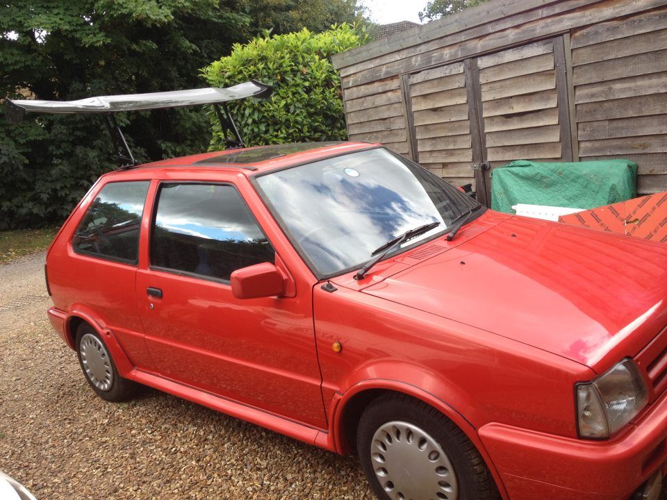

Yes my brother got bored and put his RX7 spoiler on my little K10..

It's look like mircaeroplane looool
Wicked cheers pork they will be great an roadside modding just proves dedication lol its much better now I managed to rent a garage
