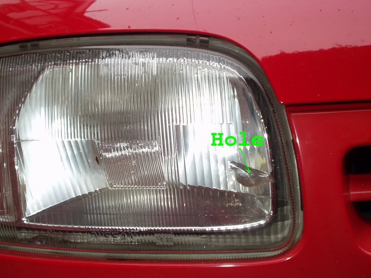

Iv'e got a 1995 K11 Micra and the drivers side headlight has got a tiny hole in it.
I think a stone or something must have hit it because it's got an inner chip (i.e. the outer face of the headlamp is smooth but there is a pice of glass missing from inside)
Here is a picture:
http://img.photobucket.com/albums/v495/stevenmoody/P1010016.jpg
The hole is about the size of a pin head. It seems to have been ok for the whole time in which my grandad has owned the car befor passing it to me, i just wanted to patch it up.
Anyone have any ideas of what I could use to seal the hole or somekind of sticky transparent plastic to make a repair over it ?
Iv'e only noticed it recently because of the small amount of condensation which develops on the inside of the glass of the unit.
Any ideas ? I just though that £14.99 from halfords for a kit containing a glove, glue and patch was a bit steep.
Cheers
Steve :D
Use any form of clear silicone sealant, its wots used around sinks and baths to stop the water from getting down the sides. Squeeze a bit in, let it set, and then use something sharp to cust the top off so it sits flush with the front of the headlight. A stones probably hit it, it usually causes more damage to the inside of the headlight rather than the front.

just buy a headlight from the scrappy, should only be about £5/£10

I would if I could find one locally (portsmouth) which has a k11 :D
I found one with a k10 but thats no good :( :D
I think that would be best, try any find one in a scrappy
I might try that sealent thing as a temporary fix

seriously tho... the glass can be changed... if you can pick it up cheap.. ive got a few lying around u can have one for free..
