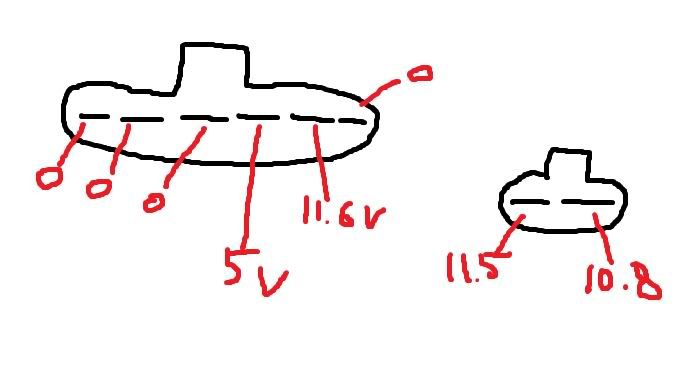

Ok, So I double checked the reading today and this is what I got.
Voltage across the battery was 11.6 V cause its a little flat
Does this look about right? How close does the timing need to be to get it to fire, im used to vws where they'll fire up with the timing way out, and what is the correct timing for it? Got a strobe etc just not got my manual to hand
Yeah, that looks normal as far as i can remember but dont think the 10.8V reading is right but not sure.
whats the resistance between the two pins on the smaller connector (dizzy side)? should be around 0.8 ohms
