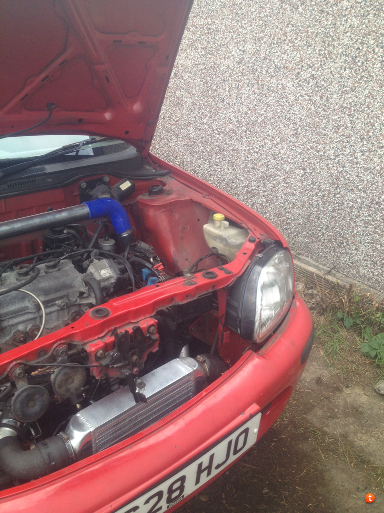

No quick rack in mine, just a standard PAS set-up, was fitted a few years back. Wouldn't go back even with the power losses....
