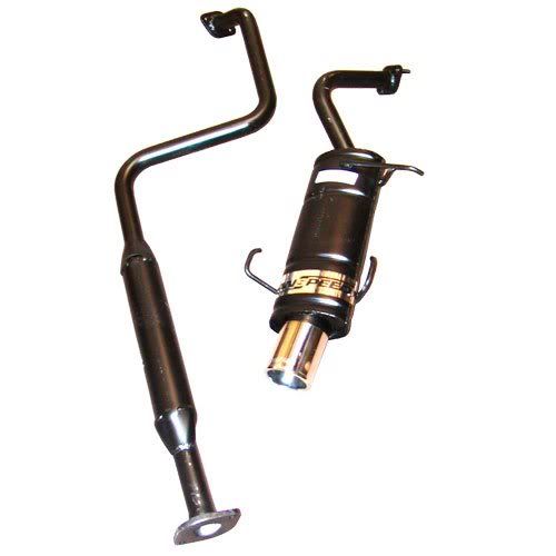

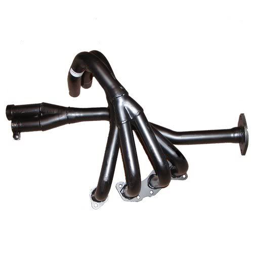

Ok, I have been reading through some of the threads on exhaust options and tbh im confused. I was thinking of a setup like this, Janspeed manifold, decat and exhaust system.
I put the links in at the end for people to have a closer look.
I have a few questions if people wouldnt mind answering:
Is this set-up the best for better power, anyone any better suggestions and what can i expect to happen to fuel intake
what does the decat actually do, is it MOT legal and is it worth the money for any gains in power
Is the janspeed exhaust system alright or is the OMP or Ashley better?
I dont want something too loud, i want it to have a nice sound and give good power gains mostly to be good build.

the best set up for good gians is, a janspeed 4branch manifold (mild steel only so wont last for ever) std cat still in the system, and 2" cat back system.
the janspeed exhaust system, OMP and Ashley are all the same bar the name..altough stainless exhaust systems have a life time garentte where as mild steel doesnt iirc ashly and omp are not stianless where as janspeed can come in stainless aswell as mild.
it wont be too loud, it will have a nice sound! but if your fitting a janspeed manifold to a cat back system it will be loud! you could quiten it down with a silancer in the system bar the back box (dont know if the exhaust mensioned above come with a silancer in the centre section)

the manifold will give the biggest gain, but will remove the 1st cat (the one that guarantee,s an emissions pass)
thanks squarepants, is that the system I showed in the links? or is the 2" cat back something else? I might just get the manifold and the exhaust system and skip the catback it depends on gains with/without the catback.

the second link is a cat back system yes...and stianless :)

the full sytem is an exhaust even the manifold is an exhaust... top one is centre centre inc back box (janspeed) and bottem pic is a (4branch perofmance) janspeed manifold

The other thought for around £200 janspeed will make you a sports cat.
i think 400 is a lot to be spending as it is on the manifold and exhaust so Ill leave the cat I think. Thanks for the heads up on the fuel though.
the std cat wont effect performance, will be fine. de-cats give 1bhp dyno proven on an sr20! its near usless de-cating a micra it would change the sound and sound crap lol and make no bhp gians. and fial your MOT.
If you are only using the secondary CAT, this will not guarantee an emissions pass, you will need to get your the secondary CAT quite hot before the MOT, so I suggest taking it for a bit of a run before hand.
Some people have passed no problems, with just the secondary CAT, others have failed.
I was running mine complete DE-CAT, Janspeed Exhaust, Janspeed CAT BY Pass, and Maniflow 4-2-1 Manifold, and it was funning like a dream. I just had sweet FA chance of passing an emissions test, so put the standard Manifold with CAT back on, still runs quite nicely, although not as nice as the RS hehe.
