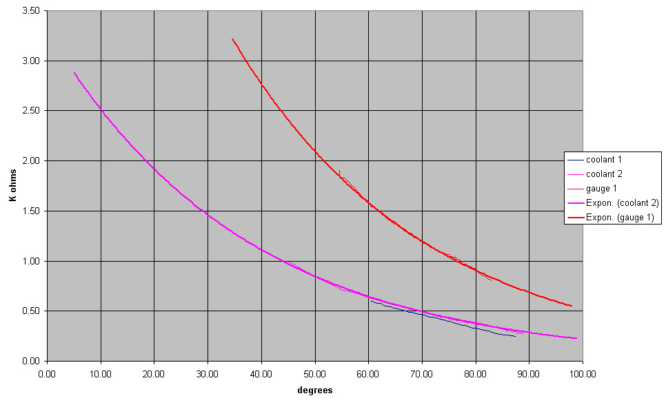

Sensor
the gauge is only as accurate as what the sensor was calibrated to.
when the gauge sensor (sensor with a single terminal pin) is at 82c it should develop approx 0.8kohm.
test by removing it, connect to a multimeter and dunk in boiled water with thermometer and check resistance at certain degrees.
I've done a test and graph to compare results to
http://micra.org.uk/threads/pollymobiles-rebuild.35251/page-119#post-704079
coolant-sensor-resistances-jpg.36618
when the resistance is correct, the gauge itself should be reading at 1/2 way.
