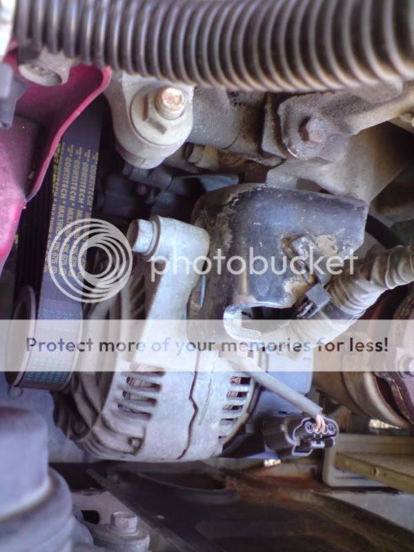

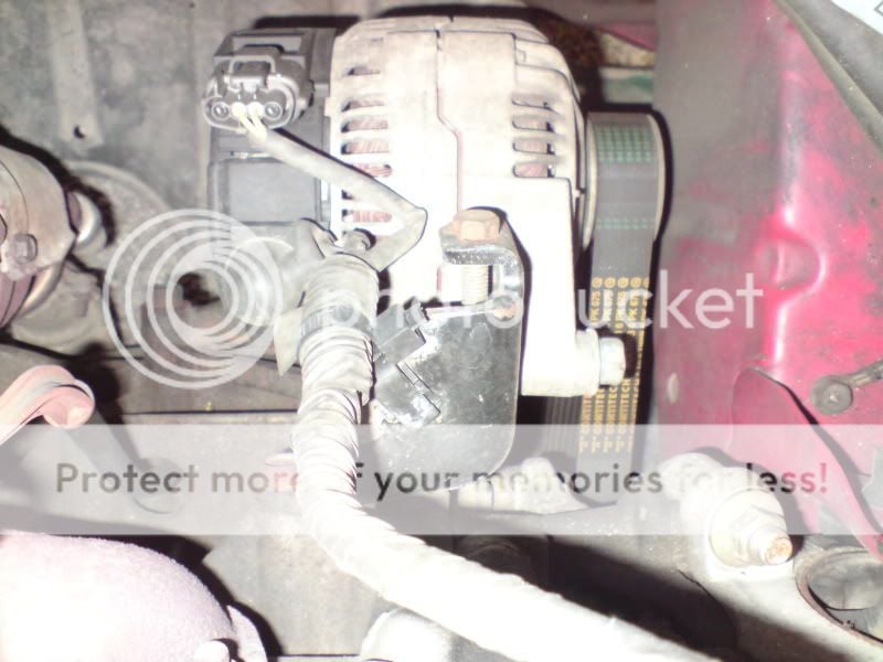

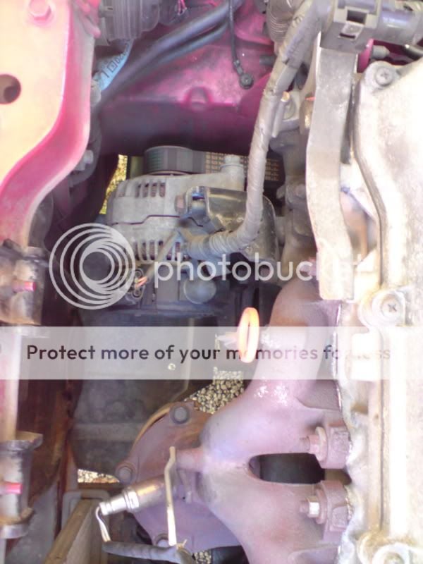

Pre-facelift k11 1.3 No aircon:
Sweet (Y). I know the blocks on the pre-facelift and facelift are exactly the same, so I'm hoping I can mount my alternator in the same place as yours. Is there a bracket holding it on at the bottom as well, or is it just the mount at the top?
Yeah, that's a good point actually. I can just fabricate my own bracket for the bottom anyway (Y)
There is another bracket at the bottom, it has 3 bolts into the block and 2 into the altenator.

heres them pics dude they were sent off yesterday! 2.5kgs from 2 brackets and bolts and a belt lol!!!!!!!!!!!!!!!!!
also an extra bolt may have worked its way into the bag by accident you will tell which its the smallest
